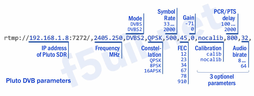

I have built a Portsdown4 and it seems to works fine, but I cannot work over the PI6ATV repeater because they require other PID settings (PMT 100, PID video 101, PID audio 102, PCR 101). I can change most of these settings in Menu 3, but is seems that this doesn't have any effect on the output signal (e.g. video PID remains 101). Am I doing something wrong? 73's de PA7RP

I take it that you are using a Pluto with the Portsdown 4. The PIDs can be changed if you use a LimeSDR, but there is no way to change the PIDs on the Pluto when used with the Portsdown 4. This facility was not included by F5OEO in the Pluto Firmware version that the Portsdown uses. The only parameters that can be changed are illustrated in the image below:
Sorry that I can't help.
- Parameters-PlutoDVB-EN.jpg (62.73 KiB) Viewed 6006 times
