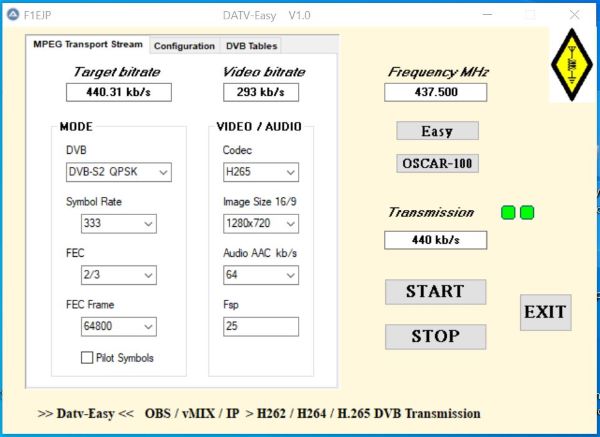

Post by F1EJP » Thu Nov 18, 2021 11:44 pm
I started a new development > Datv-Easy for >> Windows :D
>> first for the LimeSDR mini
I await your comments or suggestions!
First tests in progress.
73 Dominique F1EJP

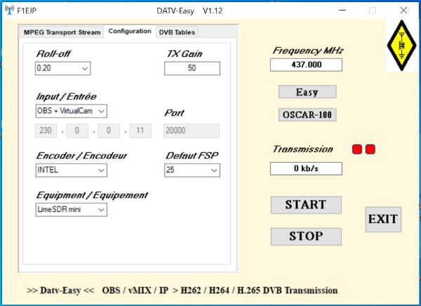

F1EJP
Posts: 81
Re: New soft DATV-Easy V1.0

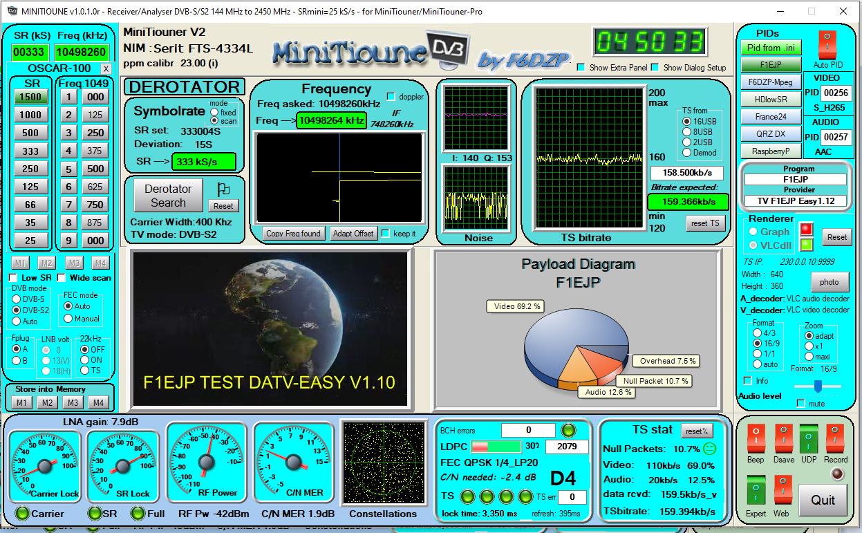

Post by F1EJP » Tue Nov 30, 2021 11:46 pm
new Screen
In test on QO-100
73 Dominique F1EJP

Received the test transmission :o
Valid point Mike, USB relay must be added.

Post by F1EJP » Thu Dec 30, 2021 12:23 am
Currently version 1.15 being tested on QO100 regularly
Operational from SR 25Ks to 1Ms in DVB-S2
> Still to be tested with an OM equipped with DVB-T reception of 125 khz at 1M
> Still to be tested by an OM on Pluto because I don't have one.
(the driver for the LimeSRD mini or Pluto must be installed on the pc)
This software will not be able to compete with the Portsdown or the Pluto with the software of Evariste and perhaps not with the DATV Express!
It is based on FFMPEG and GNURADIO modules, all adapted and configured under Windows.
I spent a lot of hours trying to get the best result.
It will allow you to have fun at a lower cost since only the PC with the OBS or Vmix software and the SDR module are necessary.
You need a pc with an I5 processor and if possible I7 either recent or with an NVIDIA card
I will soon put the file on VIVADATV forum for testing.
73 Dominique F1EJP
