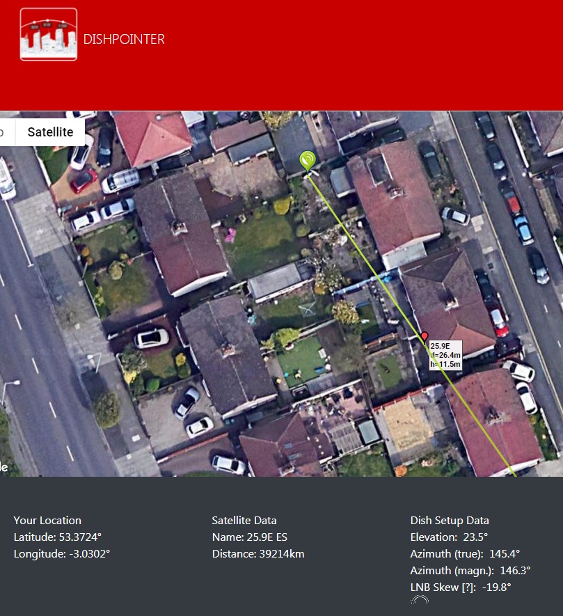

https://www.dishpointer.com/
is handy, as it has a draggable marker that shows how high off the ground the line of sight is, at any distance from the dish. Typically, the original rotatable dish to the right is partially obstructed to QO-100.

Thanks Brian, that's a handy app. And thanks for all the other replies, I am going to try a laser pointer on the rim of a temporary installation of the bigger dish, just to be sure I am not wasting signal due to a less than optimal location. It's all a bit tight, balancing feed line length, view of Oscar 100 and keeping 'er indoors semi happy! I am also striving to have it in invisible to neighbours and passers by.
