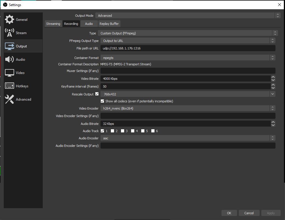

Just for information and slightly off topic, what I do now is use OBS to output a high data rate transport stream over UDP/Ethernet which is sent to a remote Nano, then on the Nano I use a HW accelerated version of FFMPEG that transcodes down to the low rate Transport stream required for NB DATV. This is then sent to a bespoke DVB-s/S2 or DVB-T transmission stack that drives the SDR (Lime. Pluto or DATV-Express).

My problem is I cannot even get past the test setup to make sure OBS is outputting to VLC as was in the setup on the forum.

I get a transport stream out of OBS by using the recording setup.
To start the stream I click on begin recording on the main panel.
You could try sending it to the loopback address 127.0.0.1 then in VLC listening to that.
- Charles

Thanks for responding. I duplicated your screen shot and tried both the local IP and the loopback addresses for the stream URL and VLC is still not showing any activity, not even received packets under statistics. I have a new computer coming this week and am going to try again on a fresh machine hopefully with a different NVidia graphics card. I'm still not sure if it's a hardware or software conflict going on here. Every example of using OBC with VLC does not work. And examples of using HDMI Ethernet Streamers with VLC are not working either.

You must click on the "start recording" button using my setup, not the "start streaming" one (I initially made that mistake).
