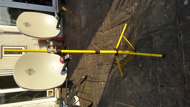

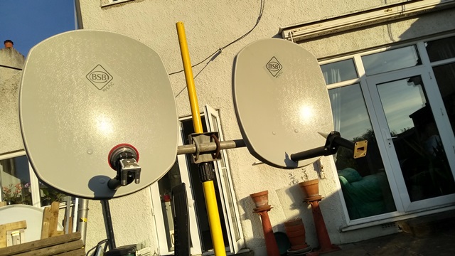

Having recently received a spare Bullseye LNB ($29.99 delivered from RTLSDR shop via AliExpresss) I set about giving it some gain for portable use. From my stock I extracted a BNIB BSB Mini-dish and had a look at the kit contents. The original LNB was not plastic encased like the modern variety so suits a 22mm round 'pipe'.
Removing the plastic case from the Bullseye (6 plastic clips that can be gently prised open) revealed just that, a round body of approximately 22mm diameter, with some of a box assembly for the electronics getting slightly in the way. By splitting the original BSB LNB boss in half and carefully grinding away plastic (glass filled nylon I think, good stuff) it was possible to mount the LNB as BSB intended.
Mounting the dish on a suitable cross-bar and tripod, I pointed it at the sun and experimented with the angle until the centre cap was illuminated by the suns image. So pretty much at the focal point then :-)

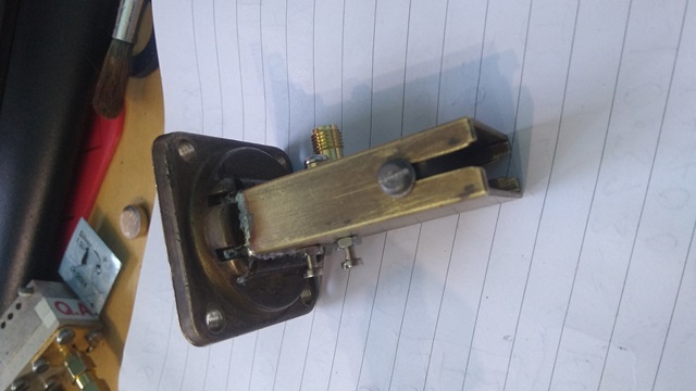

With RX sorted I moved to TX, hoping to use my Pluto's 5th harmonic and amplifying it a bit. I recalled I bought a "dish feed to WG16" from Bob Platts about 20 years ago, this fits directly into the LNB mount with a few turns of tape to give the holder some grip. Just got to build/convert an old Gunn diode 10GHz cavity to SMA feed and I'll be good to go.
Both dishes can be mounted as shown, or a bi-quad feed for 3.4 can quickly be substituted to the TX dish

if I want to use 9cms.

SMA to WG16 transition made and set up, such as I can. MER 17 at 40m down the garden.....
Its a start ;-)

Gain is gain. You will probably find the receive amplifiers will give a few milliwatts on transmit when saturated.
You will probably need a negative bias supply. Have a look at the data for the Franco boards for some ideas.
