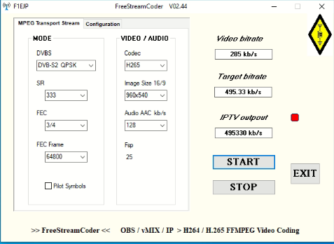

As promised, here is a little software that will replace the script I distributed V01.20 which allowed ffmpeg to be used with OBS or VMIX.
The software is a first distribution in version V2.44
> Thanks to Jean-Pierre F6DZP for his advice and help in developing better flow calculations than some calculators on the Internet!
It comes with everything you need, No need to install FFMPEG
New compression enhancements by offering the default settings optimized for compression.
The advantage is being able to use the NVIDIA GPU or recent Intel processors which integrate a processing unit but software compression is also offered.
The Stream which is encoded in mpeg-TS outputs in UDP
I use it as an IPTS input on the Potsdown 3 and I believe that there is an Evariste F5OEO version of the Pluto firmware which allows UDP input
Good image definitions are obtained for fairly low bit rates.
> I hope your feedback from tests which will permit the software to be optimized. :D

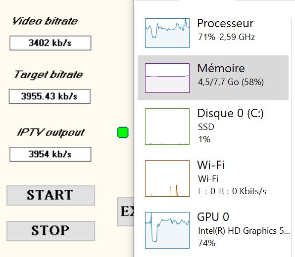

G7VVF at more than 1M there is some problem with support of INTEL, is it you case ?
I think with Intel it's require a powerful processor
I have the same issue with my laptop but not with my PC with NVIDIA
Look at the task manager to see is there is saturations
73 Dominique
