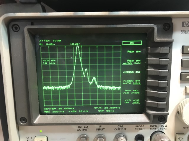

Unfortunately, this is not true as the Lime LO is switched to 31MHz for lower band operation and appears at about -40dB down on the main signal - there is also a mixing product starting to appear 2 Mhz up at 33MHz.

Exactly the results i found while experimenting over christmas and now why i use transverters for 21MHz and 29MHz from 146.5MHz
Interestingly you get a 30MHZ signal if you generate 28 or 29MHz signal but if you generate 31 or 32MHz the 30MHZ signal goes away!

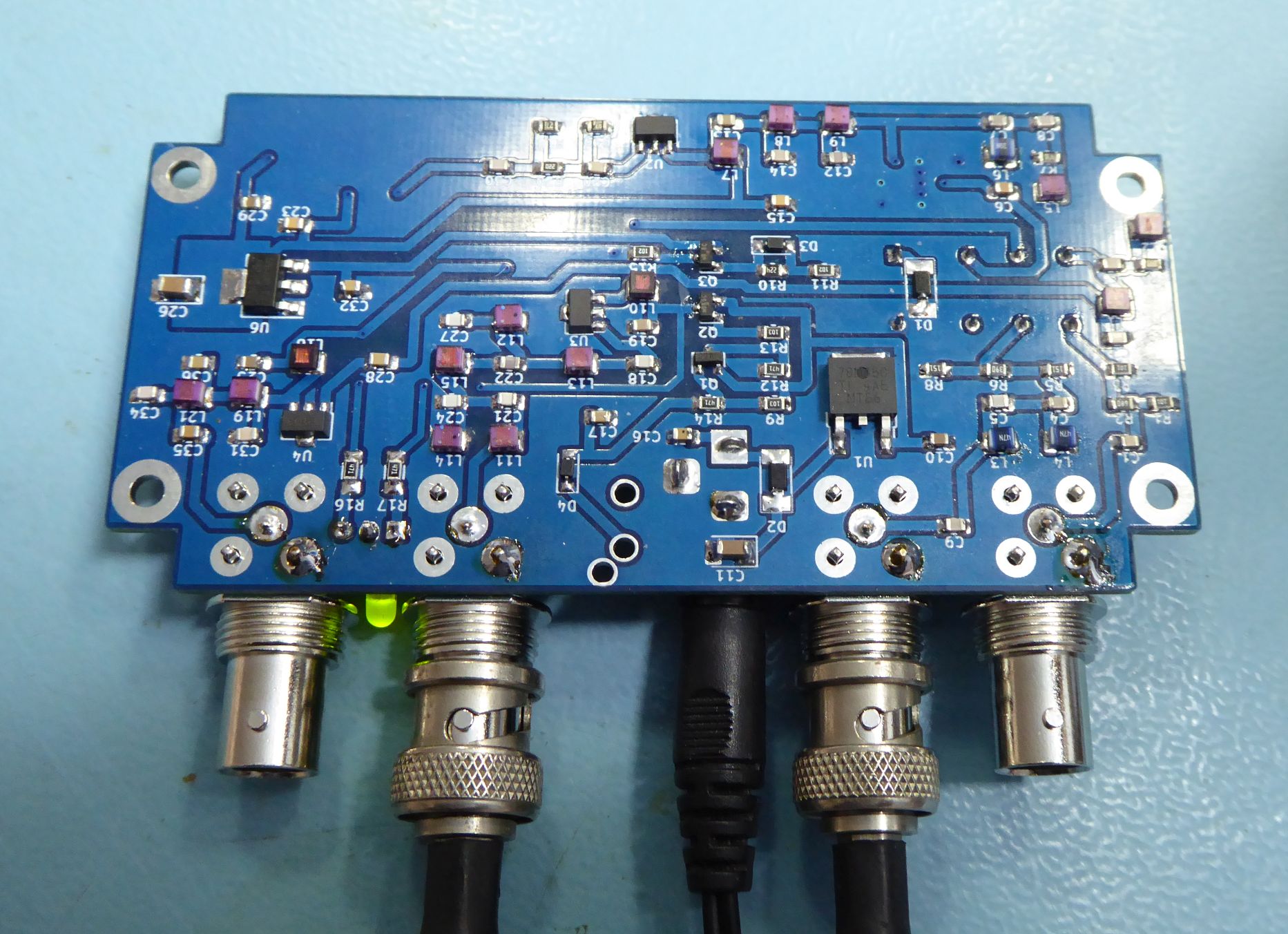

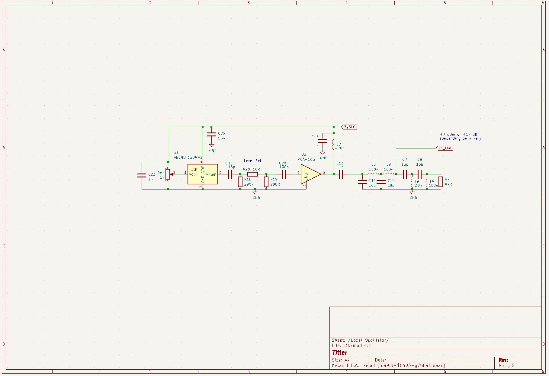

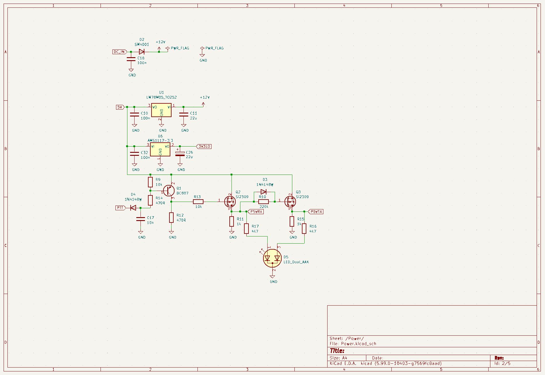

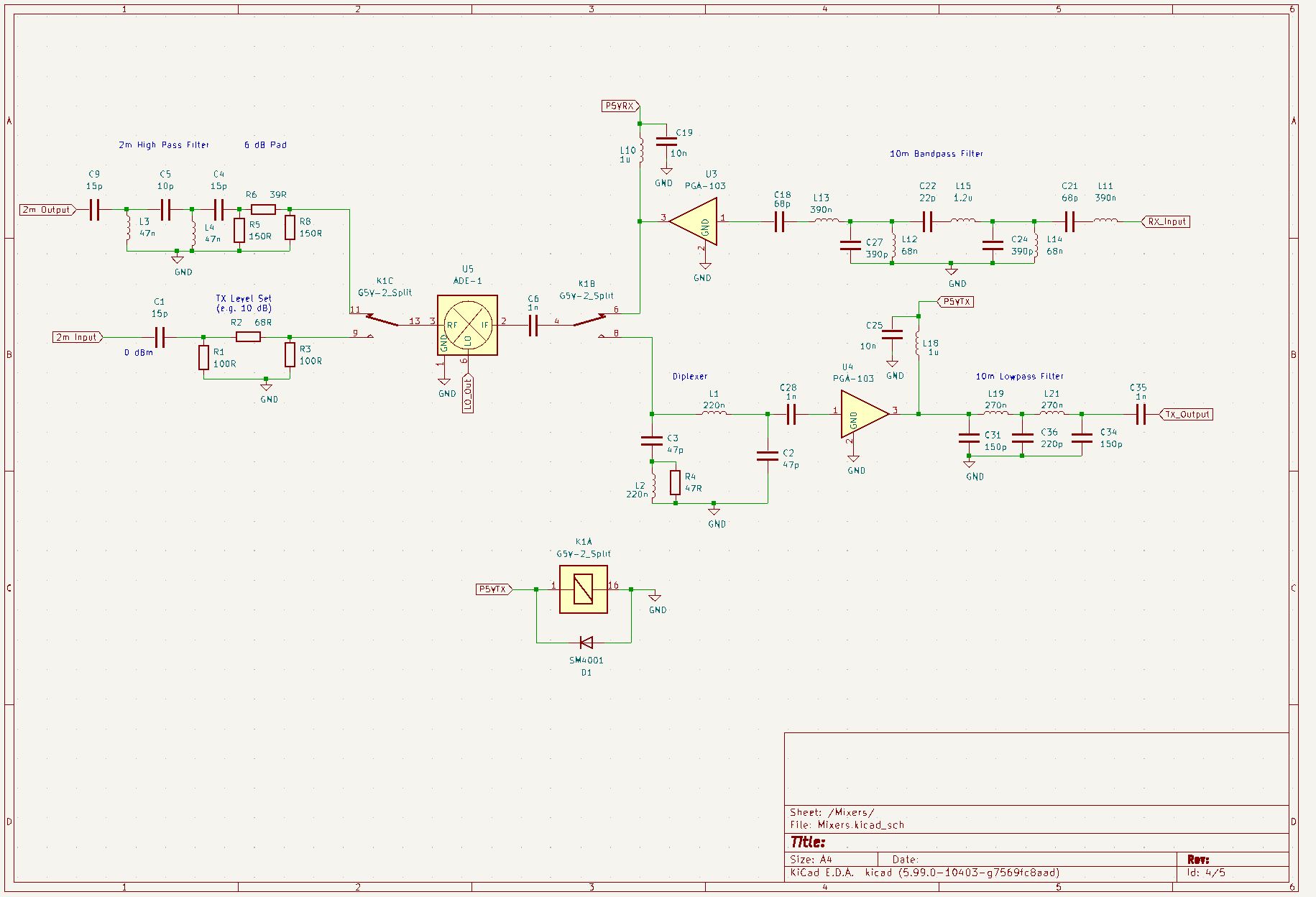

OK - expecting PCBs soon. I want to know if I can get away without tuneable coils which are difficult to get these days. Also it's quite small SMD based to fit in a little box. I have decided to try using an LO module - I was originally using G4DDKs Butler oscillator circuit but discovered it is now very hard (expensive) to get 116 MHz crystals.

The last few bits finally arrived so I completed it this evening. OK so I didn't solder in the BNCs fully - just in case. Seems to work. For reference, I use a 120MHz oscillator so 29 MHz coverts to 149 MHz.

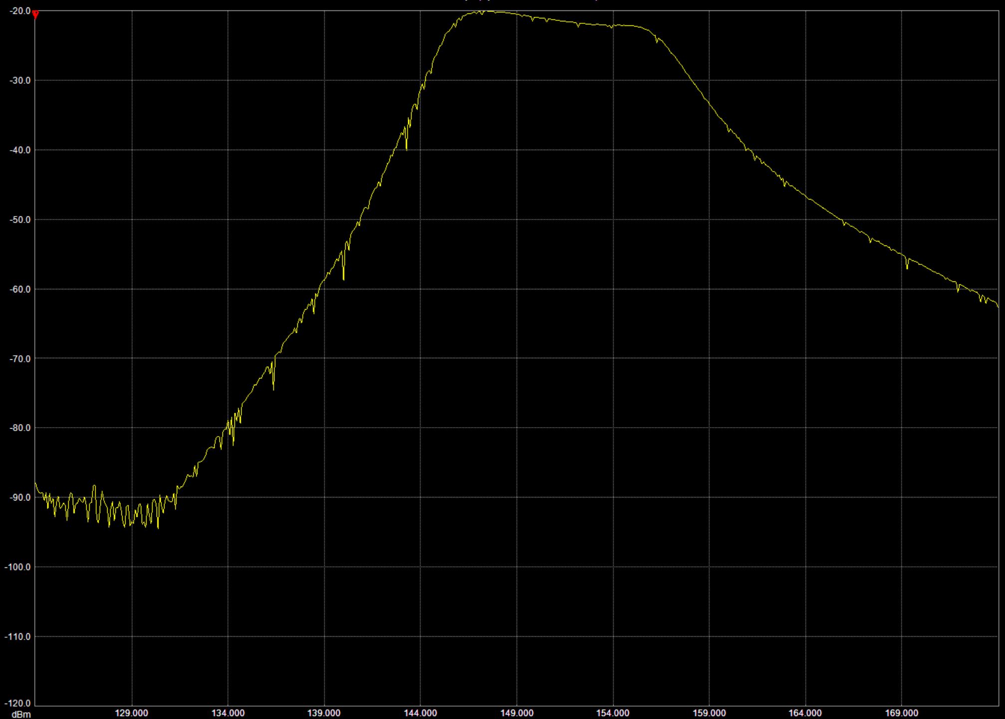

On receive there is 10 dB gain but anything more than -20 dBm input starts to create spurii. That's probably not surprising as the PGA 103+ isn't specified on 10m, largely due to the input match, but has well over 26dB gain and would be over-driving the mixer. Maybe a different pin compatible device with lower gain might be better. I had planned to use a Gali 59+ but I don't have any in stock. Even so, on 10m it might be sufficient just to have the mixer and dispense with the input amplifier. Meanwhile if the input limits are an issue, stick an attenuator in front of it. The bandwidth was as expected, the 10m bandpass filter is not very sharp about 23MHz to 30 MHz -20 dB. It's not great as I used standard value parts. There is quite a lot of LO leakage but not so much to be a problem.
On transmit the gain was also 10 dB, that's partially governed by the input attenuator, in this case 10 dB. It will easily give 10 dBm out but harmonics start to be an issue and in any case at that level the spectral regrowth would be too severe. The spurii are at least 60 dB down. The bandwidth is quite high as there is only a low pass filter to limit it.

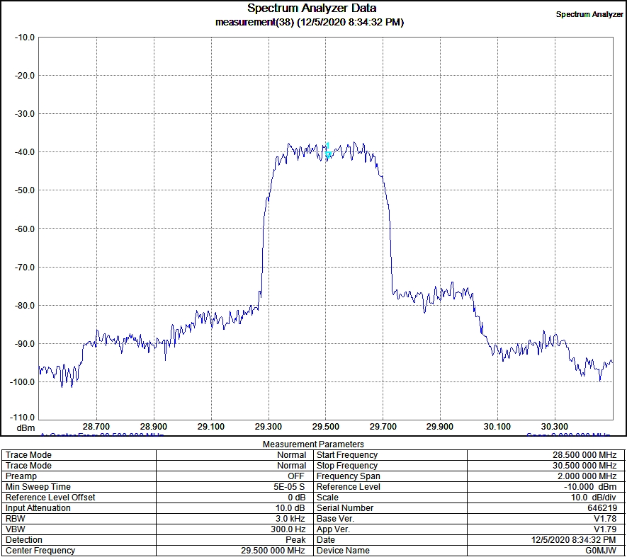

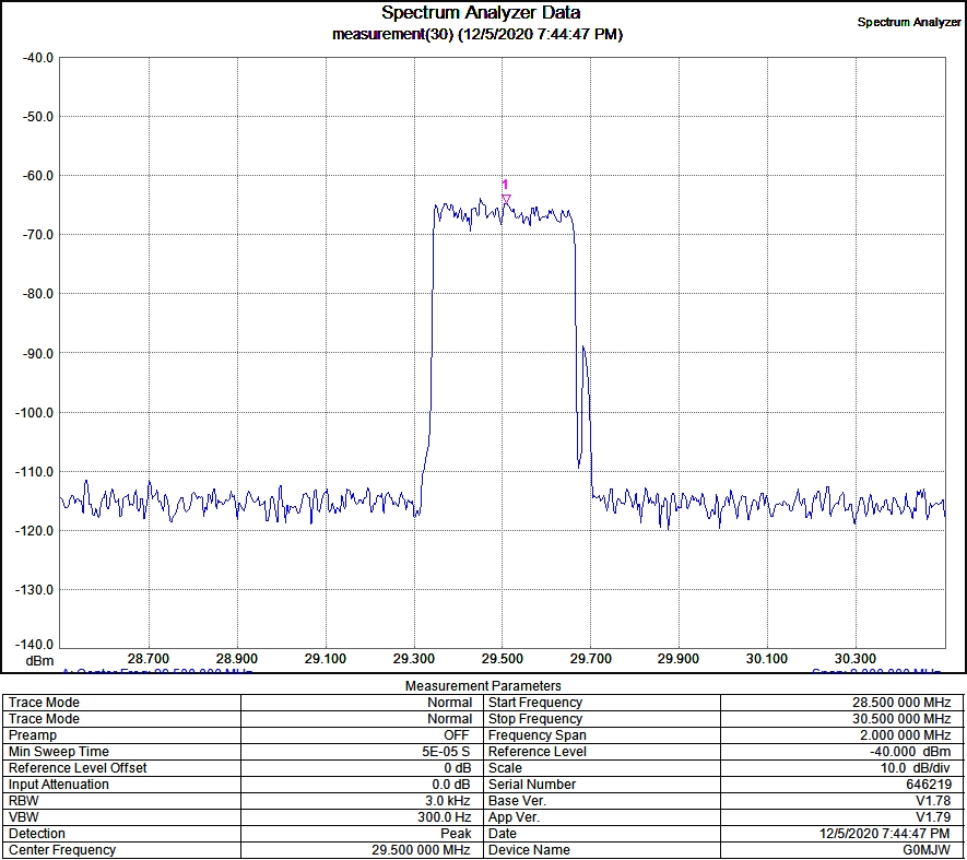

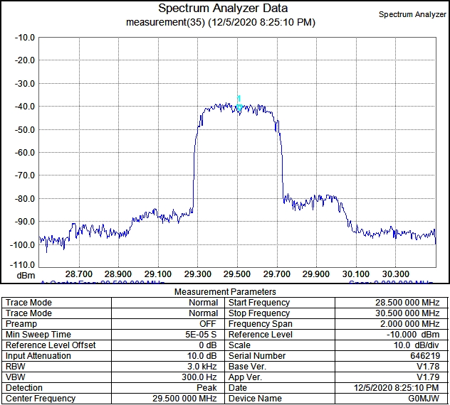

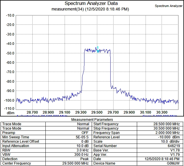

Time for an update. With the first version of the converter I can generate DVB-T at 29.5 MHz that looks almost as clean as it does at 149.5 MHz. This is with the Lime / Portsdown.
Ignore the date and time as the analyser RTC is not set correctly.
The shoulders are at least 50 dB down. With my driver amplifier inline I get a similar result - this is to deliver the drive for an MRF300AN PA based on the NXP standard design.

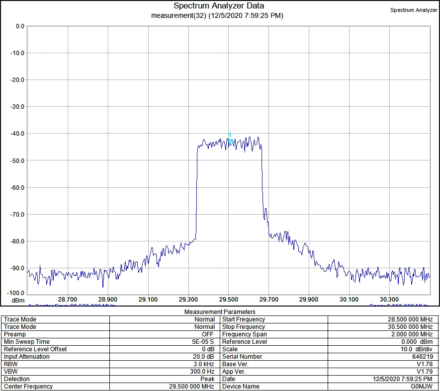

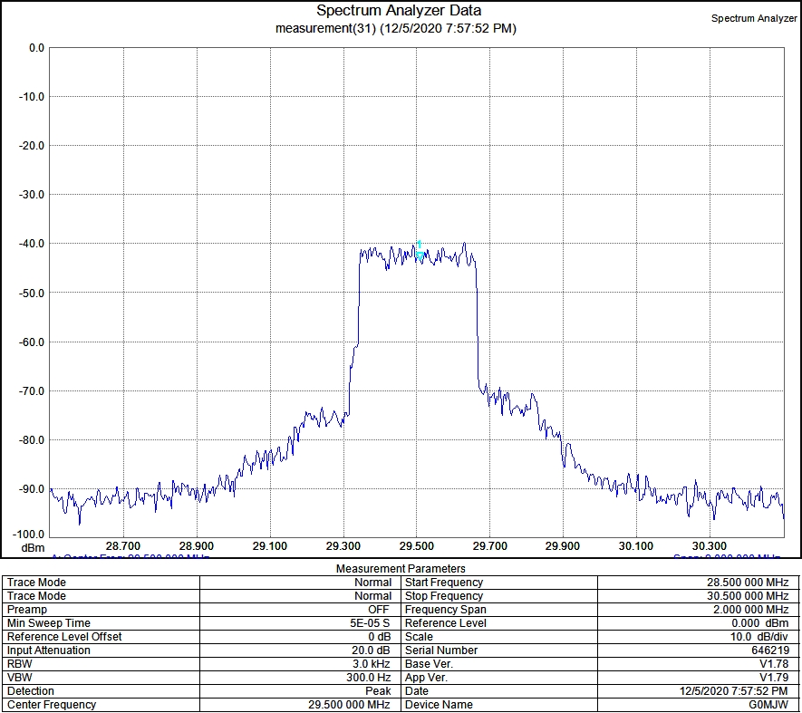

A few tests with the Pallet ensured, initially I have over 100W but it wasn't very clean, that was with 100mA bias current so as expected. More sensible tests arrived at 1A appearing about the optimum bias. Two plots, 80W output and 60W output.
So it's not super clean but it's not bad. At much lower power it gets better. Next post...

At 30W it is not at all bad. This is only 10% of the device maximum, it is taking 2A ant 50V so 30% efficient.
More work to do but some hope. I should be able to get a lot more power out in DVB-S2 so just to prove that, here we are at 120W. Not pretty but...
