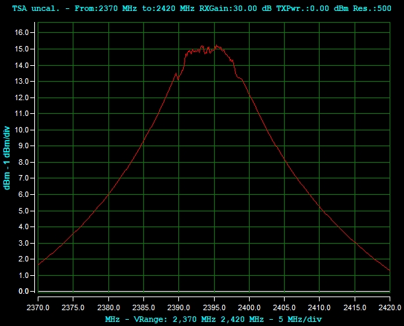

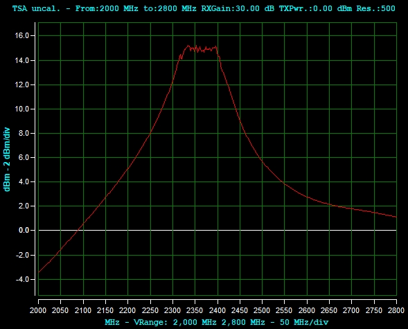

I'm building up bits of kit for 13cms for 'out and about' and to help my front end escape Wi-Fi, sundry other stuff thats around on 2.4GHz etc I'm experimenting with pipe-cap filters. This article does a great job of explaining and developing one. http://www.w1ghz.org/filter/Pipe-cap_Fi ... isited.pdf
With short probes, I can have a 4MHz BW, by adding probe extensions the bandwidth increases to 60MHz but the slope of the filter isn't as good.
So some sort of compromise is needed.
If I am out /P on 13cms, is there a good SPOT frequency to use?
What is the power limit throughput for a filter like this? I imagine that some very high voltages will quickly arise with increased RF power, so maybe RX only.
SATSAGEN pictures help illustrate.....worth adding that insertion loss seems to be under 1dB....
