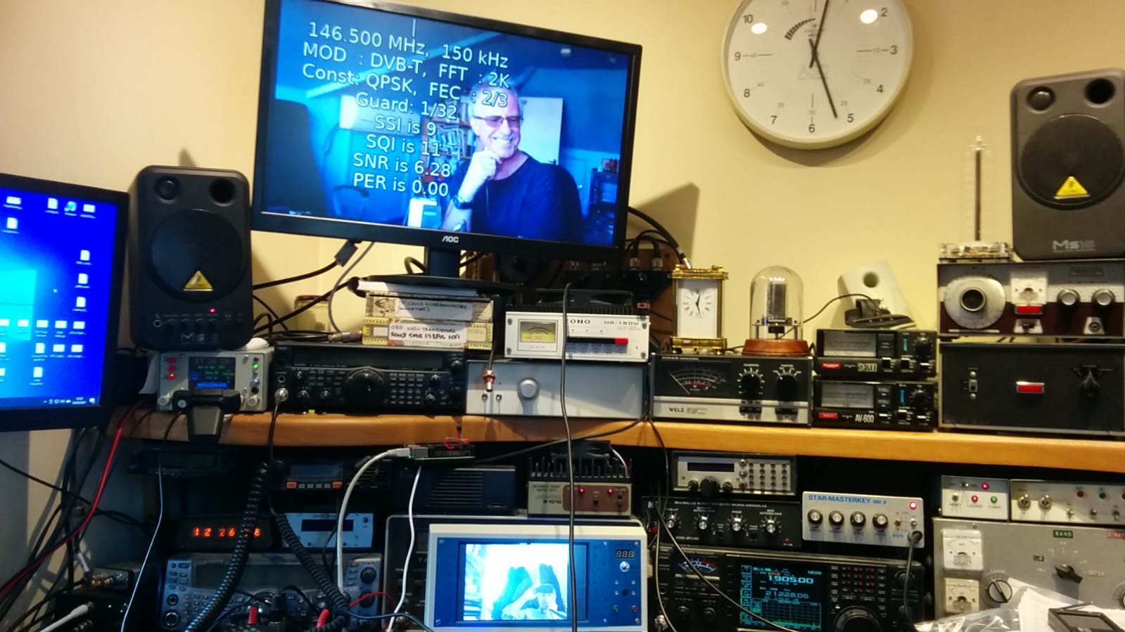

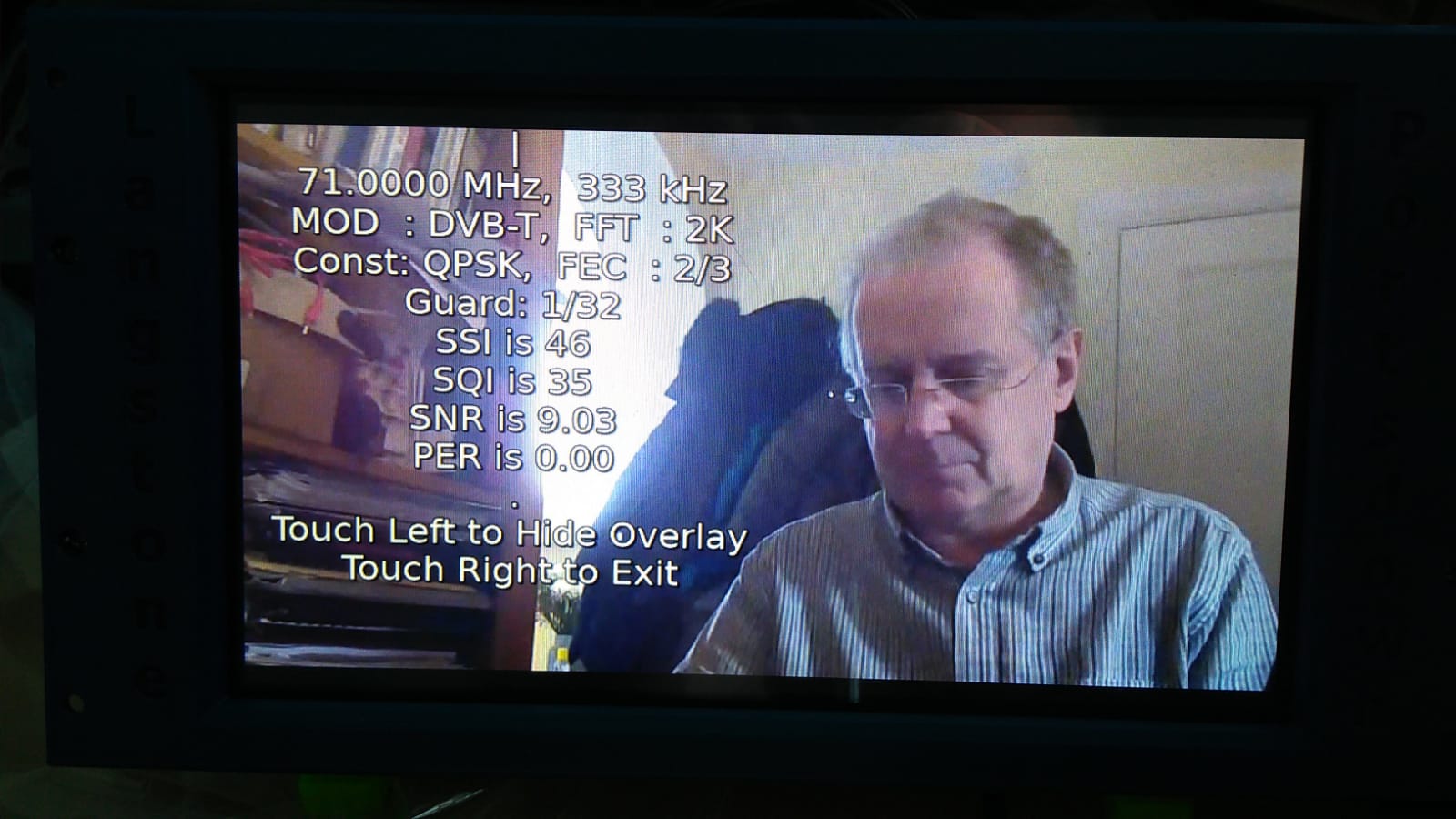

On Sunday (which is the weekend) we arranged to try cross-band duplex using 4 &2m. After various attempts using different combinations we eventually established reliable duplex with me running 1 watt DVB-T 150ks on 146.5 and Martin a few watts of 333ks on 4m. Other than the 2x4 seconds delay it eventually worked, with a little bit of help from 1.905MHz ssb talkback. I was unable to reliably receive MArtin on DVBS2 at much higher power, I suspect that the Knucker NIM has better ears than a MiniTiouner even with an Amsat SAW preamp (only 11dB gain). It would be interesting to know how much more gain I need to 'level the playing field' as despite having to run much less power for DVB-T it seems to make the trip easier with less. Not sure how to compare the raw signal levels and SR's etc.
Don't forget a typical satellite LNB has ~55dB gain at 10GHz /L band IF so a low noise pre-amp at MH plus a 20 dB line amp seems to be about right to drive the 4344 NIM - a general guide is to get the MiniTuoine RF level meter to be around 60 - 70.
The Knucker 4762 NIM on the other hand is designed to connect directly to a terrestrial antenna so whilst it will benefit from a low noise pre-amp it gives reasonable results barefoot - it certainly does not work well when driven with the same level as the 4434 NIM.

Couple of pics for interest (?)...
Martin_at G4XAT.jpg (139.55 KiB) Viewed 3001 times

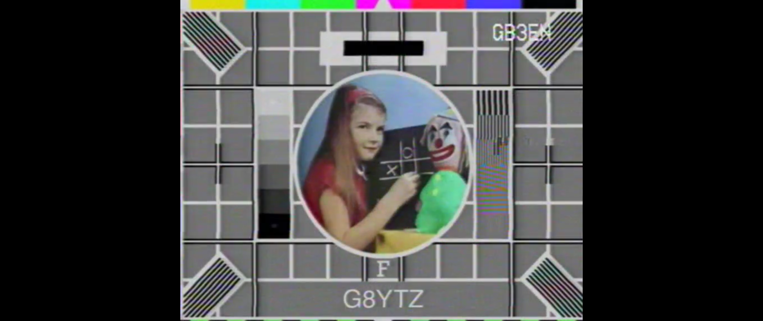

I maned to (just about) get into GB3EN on 23cm @ 1MS/s Changing the FEC down to 1/4 did not actually make much difference, but I got there. If I move the shack upstairs the much shorter feeder would probably make all the difference.
G8YTS 1MSs GB3EN 4x3.png (1.39 MiB) Viewed 2923 times
