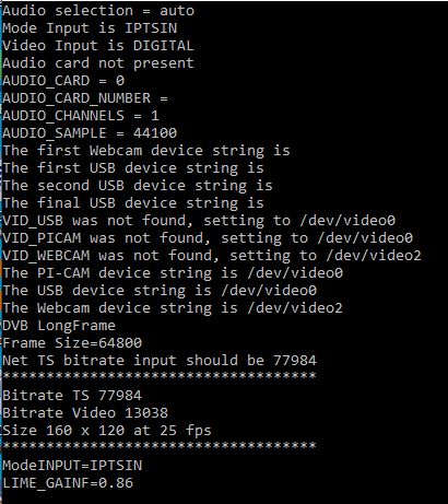

Hello Dave G8GKQ,
I'm trying the command line on PorstDown 2020 and it won't start, I see: Do you have a solution ?
Dominique
F1EJP
Dominique
F1EJP
Re: Script for generate IPTV with OBS + FFMPEG + NVIDIA card
Thanks for pointing this out Dominique.
My apologies - insufficient testing on my part. I have posted a corrected version above which should work. The problem was that forked processes in the bash script (a.sh) did not behave correctly when called from an external ssh session.
