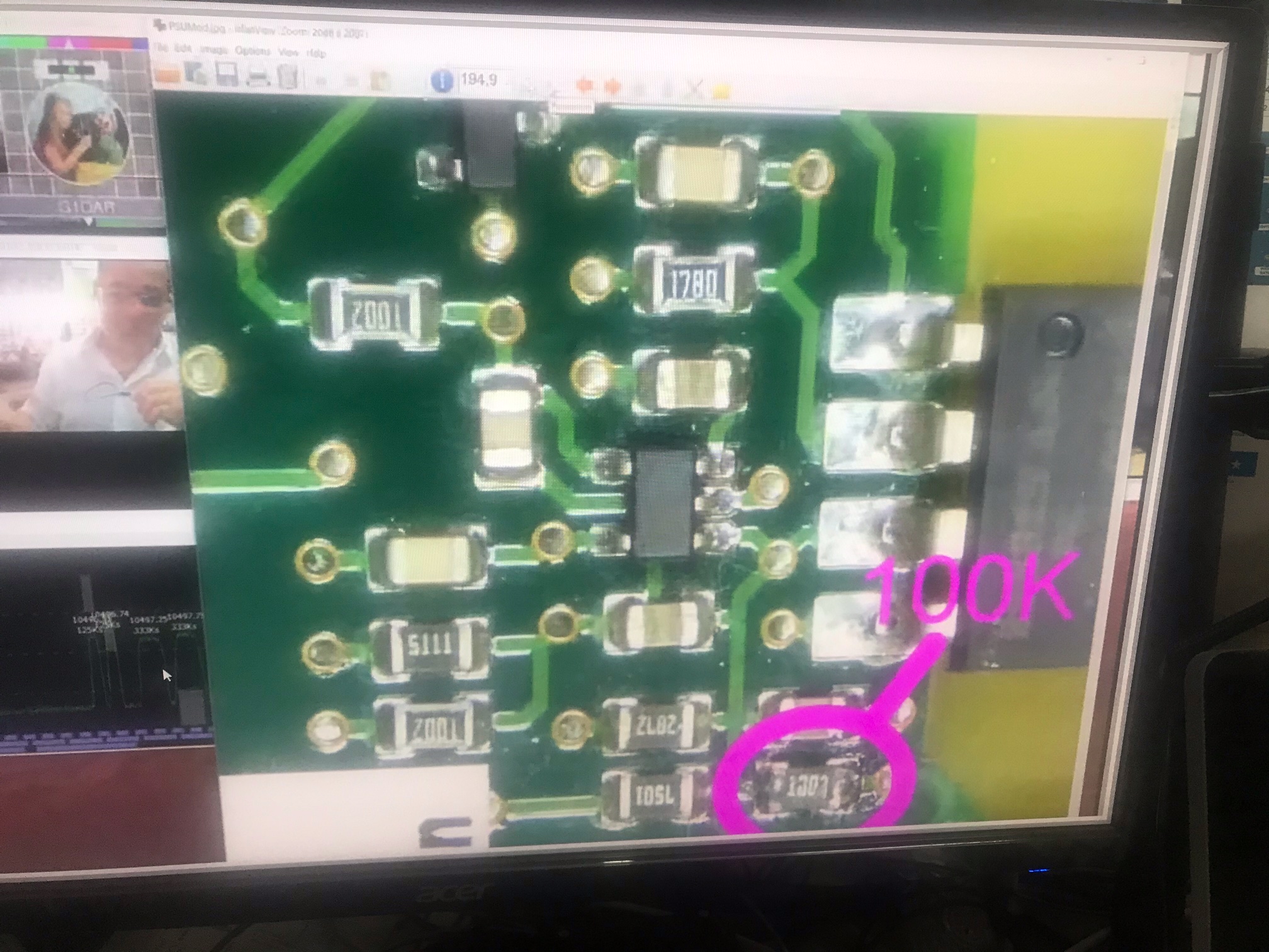

Mike has now posted the original
Put a 100k across the marked resistor.

Nobody said they won't go to 28V. The patch I showed was just to get to 28V which is where I wanted it to be. I worked out the circuit more or less and gave the voltage feedback a minor tweak. 32V may be possible with more tweaking. If you want 32V without tweaking you could always add an isolated 5V PSU in series with protection diode. However...
We assume output power scales approximately with the drain supply squared. 28x28 / (32 * 32) = 76.5%. Linearity though does not scale in the same way. It is unknown how much more power you will get on DVB-T with 32V vs 28V with acceptable shoulders. Also device proximity to self destruction scales very rapidly with supply voltage.

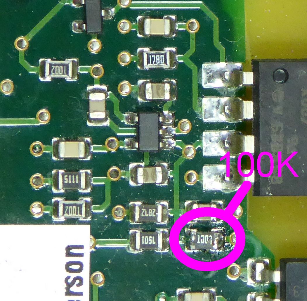

Here is a version of the image not sent via QO100 and photographed.

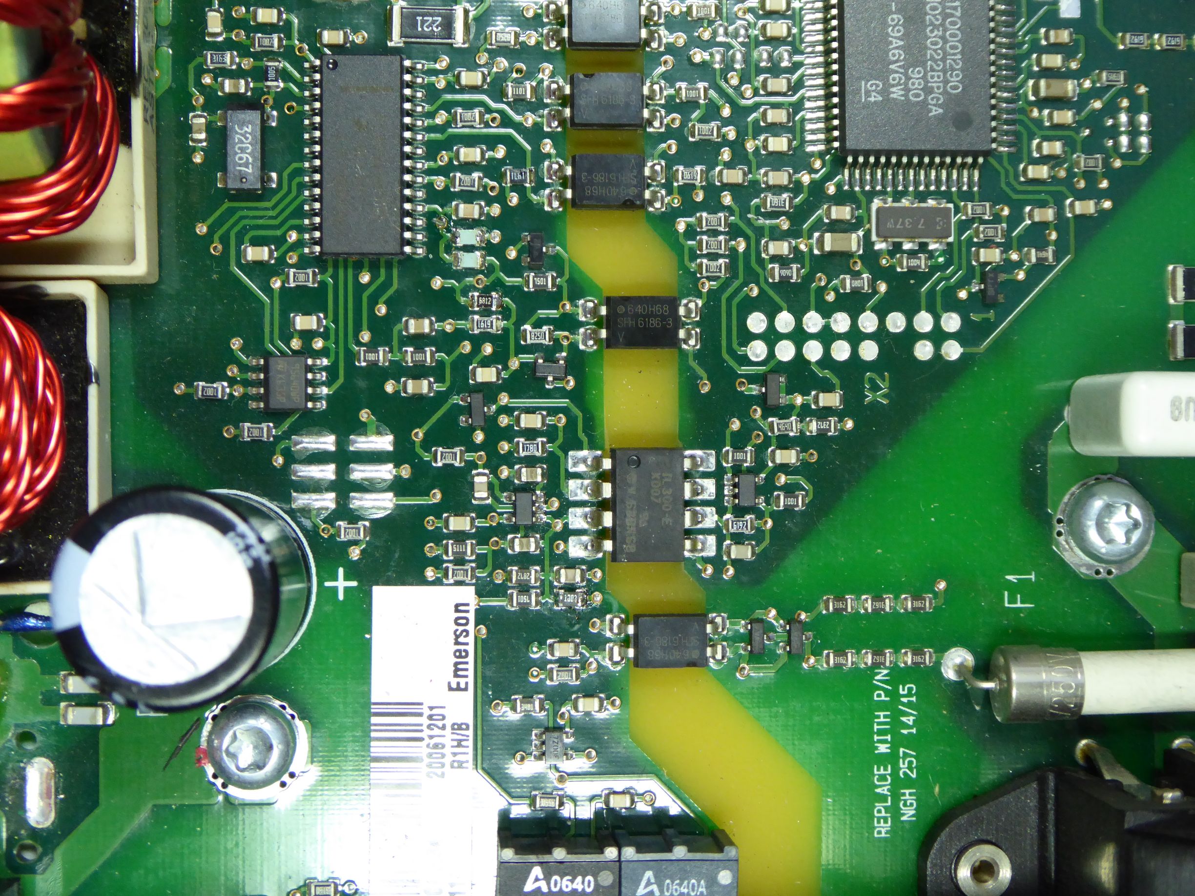

Here is a wider view. Look up the IL300 and all will become slightly less opaque.
The resistor is part of an op-amp circuit feeding that linear opto-isolator.
