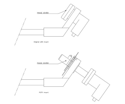

There should be well under a dB degradation with the POTY and a proper lens. Either the lens is U/S, the wrong lens, or it's in the wrong position. A lot of people get it in the wrong place as the larger 2.4 GHz reflector doesn't fit without modification of the feed mount on many dishes. I have given up trying to explain this in words so I have attached Hans Holsink's diagram which makes it very clear what to do.
If it won't fit like this on your dish you have to modify the feedarm. No ifs, no buts.
(Note this is on the Wiki)
Re: POTY, DIsh, Bullseye & beam questions....
Posted: Sun Dec 20, 2020 11:05 am
by m0pnn
Hi
I have seen your many explanations it must be very frustrating. I know its something I must work on to get right.
