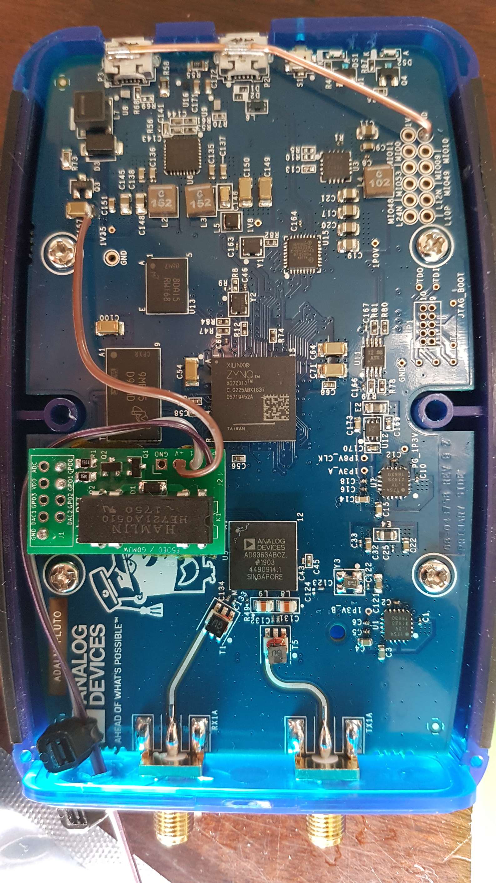

I've fitted the relay output mod to the Pluto and and i cant get the relay to switch. Is there something i need to enable in the new firmware?
I cant measure anything on the GPIO pins.
Has anybody had this problem?

Thanks for the reply. Yes the new firmware is installed and I thought I needed the diode. Will fitting the diode prevent it from working?

You only need the diode if you buy a relay without a diode already fitted. It should not make a difference - look at the schematic and analyse. When you say it does not work what do you mean? How are you trying to operate the relay? I assume in the web interface of the F5OEO software?

I don't know. Are you sure the diode is in the right way around, the transistors are what they claim to be and the 1k5 resistors really are 1k5?

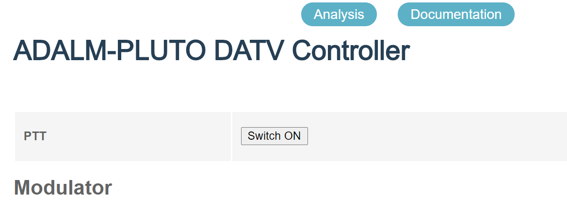

When you say sending stream via VMIX, are you using the PTT button on the interface? The one that controls the PTT relay? Transmit ON / OFF?

I thought the stream switches on the relay?
It says under "PTT output" The PLUTO Firmware now supports a PTT output so that when a valid RTMP stream starts the PTT pin changes state to allow amplifiers etc to be keyed.
I don't have the ADLAM-PLUTO DATV Controller screen like you have, I've googled for it but i cannot find it. If need that to switch the relay on can you give me a link please?
All the components are from Farnell and are correct plus the diode is in the correct way around.

Post by g0mjw » Tue Jul 21, 2020 4:00 pm
Just put the pluto address into your web browser. It also has all the instructions for using the stream
