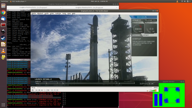

I don't think its a linux problem, I have had it playing on my Ubuntu laptop:
Screenshot from 2020-06-22 15-20-06.png (259.4 KiB) Viewed 3605 times
Possibly a comparability problem between VLC and the hardware H264 decoder?
