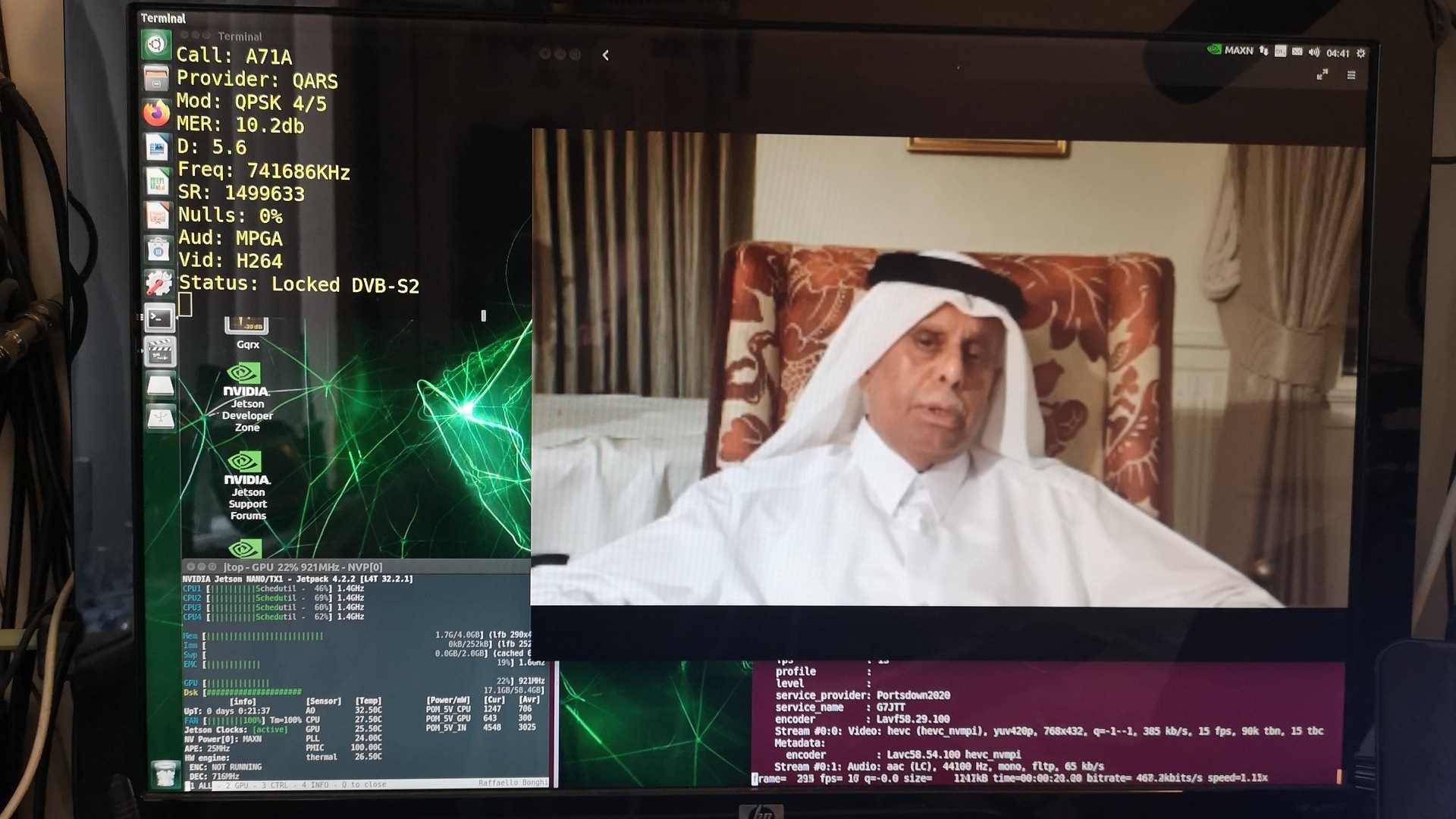

Hi all thought I'd share my setup on the Nano using the Minitiouner, Longmynd software and controlling it with Robs (M0DTS) Multi Quick Tune . Thanks too Rob M0DTS for the original Python script and ideas which all this is based on.
Firstly install Longmynd from the instruction on the GitHub site https://github.com/myorangedragon/longmynd
Then create the file longmynda.sh with the following text in the home directory of the Nano. Change the udpsink host address to your local address if you want to upd stream to something else i.e OBS. Then from a terminal window type chmod +x ./longmynda.sh to make it executable.

Now create lm_display.py in the longmynd directory with the following text
Code: Select all
#!/usr/bin/env python
# Original script By Rob M0DTS modified by John G7JTT
# Copy this script to the installed directory of Longmynd

You should now be able to open up a terminal and type ./longmynda.sh to run it, to stop it click on the info window and hit the space bar to quit. To control longmynd you need to set up Multi Quick Tune with the correct IP address and the port for your setup, also the correct LNB LO. This may even work on other linux machines in which case you may want to swap out Totem Player for VLC.
Hopefully some may find this useful and remember I'm no expert at any of this just like tinkering ! Once again thanks to Rob for the original script.
73 John G7JTT

#run the loop reading status fifo and display the nice version.
#this is the path to the status fifo file
read_lm_status("/home/g7jtt-nano/longmynd/longmynd_main_status")
This now adds a few extra lines of info to the display and don't forget to change at the end to you install directoy.
Now install guake with
Code: Select all
sudo apt install guake
this will allow us to use the drop down menu to display the info window.
Run longmynd by typing the following
Code: Select all
guake -n "Longmynd" -r "1" -e ./longmynda.sh
At this point press F12 and the "Listening on port 6789" will drop down, press again and it disappears. Find a signal (at this point totem it's not fullscreen) when you have have a signal press F12 to reveal the info window. To edit text colour and size right click on the info window and click on preferences. The appearance tab you can set the font size and colour, I use FreeMono Bold 40 and the homebrew schemes and set transparency to the far left. Now go to main window tab and adjust the Height and Width so all the text is displayed, that's it for now so close the preference window and stop longmynd with the space bar.
Now edit longmynda.sh change this line
Code: Select all
totem udp://230.0.0.10:1234 & # Start player
to
Code: Select all
totem --fullscreen udp://230.0.0.10:1234 & # Start player
this will run Totem in fullscreen.
So now you should be able to open a terminal and enter
Code: Select all
Click on a signal in multi quick tune and when locked the video should be fullscreen, to see the info window just press F12 and to hide it press F12 again.
Have fun John
G7JTT

G7JTT
Posts: 395
Re: Longmynd on a Jetson Nano
Post by G7JTT » Sun May 24, 2020 6:46 pm
Works fine on the Nano, even when using it to encode H265 at the same time too. Only issue is no audio from any one who uses express software. Can't work it out as others that use mpga audio decode fine? I'm guessing a better video play might work but so far only totem supports the nano HW encoder/decoder. Good luck getting it going on the TX2 hope it works 👍
73 John
