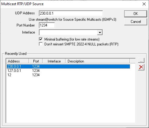

I am looking for a Real-Time TS Analyser which can receive the TS from my MiniTiouner and analyse it.
I have found TSReaderLite (https://www.coolstf.com/purchase/purcha ... dlite.html) which seems to be able to accept a Multicast or Unicast UDP source...but was not able to set it.
maybe someone more skilled than me can do it!

Re: Real-Time TS Analyser
Hi Claudio
First, make sure that your MiniTiouner is set up correctly. Here's the right bit of the minitiouneConfig.ini file that I use with v0.9beta8_9:
Then turn on UDP in the panel at bottom right
Then open TSReader Lite, Select Source, UDPMulticast and make the settings as below.
Hope that helps
Edit - Corrected IP address in minitiouneConfig.ini above
Hope that helps
thanks Dave,
now it works very well: actually my minitiouneConfig.ini was quite messed up!
now I have to figure out what all these parameters are... but that's a different story! hahaha.
Claudio
Claudio
