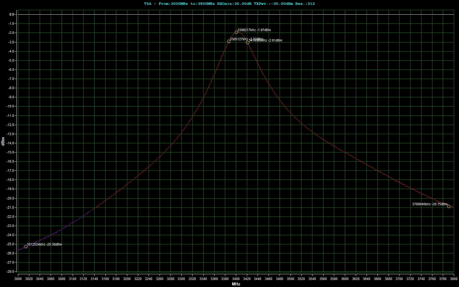

Decided to experiment with some Pipe caps (28mm) and as I have an abundance of hardline links with SMAs each end I cut one up using an Ikea pipe cutter. First to length then -8mm of outer tube. Anyway, it works very well on 3.4GHz ;-)
For the next one I'll lock a couple of nuts on the end as per the guidance here http://www.ko4bb.com/ham_radio/Pipe_Cap_Filters/
At the moment I only have threaded steel rod, but the BW and insertion loss are what I would think is quite reasonable as-is. Before I turn down and thread some brass, will it make any difference?
Trace from Satsagen. Its great :-)
3_4GHz pipe cap.jpg (540.75 KiB) Viewed 6778 times
Re: Diplexor adjustment or Pipe-Cap filters?
Posted: Mon Apr 27, 2020 9:15 pm
by g4eml
Brass screws certainly make a difference on 10Ghz. The loss is much less.
Posted: Tue Apr 28, 2020 6:20 am
by g0mjw
I discovered that at 3.4 GHz. Makes a huge difference. I have been salvaging silver plated screws from otherwise useless filters.
