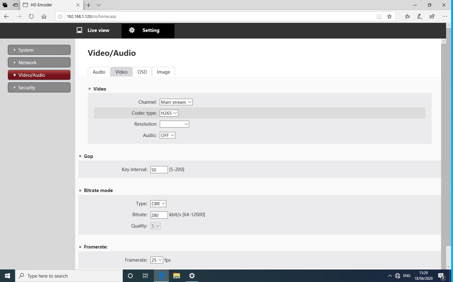

After 2 frustrating days playing with my new H265 Encoder box and F5OEO's Pluto firmware I still don't feel that I have got things working as I would like.
I would appreciate any comments and/or pointers from those of you who are successfully using this combination.
The Encoder box appears to work fine on its own and I can view its streams using VLC. However it's behavior when being controlled by the Pluto seems to be very unpredictable.
I also seem to have to reboot the Pluto regularly when it fails to respond to the network. This is despite trying several power supplies and Ethernet adapters.
However I have managed to get it to transmit H265 encoded video (sometimes). However it never had any sound. When I inspected the H265 Box the sound was always turned off and indeed the stream did not have any sound PIDs in it.
If I manually turn on the sound the Pluto stops transmitting. When I restart the transmission or make any changes to the parameters on the Pluto it resets the sound to OFF.
After some investigation I found the file 'encoder_control.php' in the Plutos www directory, I also found the setting needed is 'audioen' by looking at the H265 Box's web page. The Pluto file does not include this setting so I can only assume that the box is defaulting to audio OFF.
By adding the line <audioen>1</audioen> to the set_enc_video function in encoder_control.php I can get the sound to turn on and the Pluto then sees the sound PID and sends sound. However because the Pluto's file system is in ram my change does not survive a reboot.
Does anyone else have this problem? I suspect not. I wonder if my box has different firmware to those others are using.
Is there a way of changing a file permanently on the Pluto?
Is there a any way to use the Encoder box to generate H264 video with the Pluto?
Whenever I tried to change the encoder setting the Pluto changes it back again. Is the only option to turn the Encoder box off and use RTMP direct from OBS? That seems a messy way to do things.
Confused.... Colin G4EML

That seems to confirm my findings.
I need the box as my shack PC doesn't have a suitable graphics card to do the H265 encoding.
Actually I found it difficult to stop the Pluto from taking control. It almost seems if the H265 Box is on the network it will send it commands. I guess the way to stop that is to enter an invalid address for the box in the pluto.
It does seem to set the box automatically to give a usable stream for the SR selected. That bit of it does seem to work. I can change from 333 to 66 on the Pluto control page and it adjusts the resolution and bitrate of the H265 box to suit. But its always H265 and the sound is always off!
Yes, it would be nice to be able to build firmware for the Pluto, even for small changes like this. But unless Evariste decides to release the source that's not going to happen.
I am looking at the option of plugging a USB thumb drive into the Pluto. According to the ADI website a file on the USB drive called 'runme01' should be executed automatically. If that was a suitable script it might be a way to modify the filesystem on every reboot. It will need a USB Hub on the OTG port though. (more Cables!)
73 Colin

I have tried your suggestion of getting the sound to work but in my case it always comes up turned off regardless of the order I do things. I do have a fix but it involves modifying the file on the Pluto every reboot. I am sure I can automate that somehow either with a USB memory stick or by downloading from the PC.

That seems to have worked.
By connecting a small USB hub to the Pluto OTG port I can connect both the Ethernet adaptor and a USB flash drive.
On the flash drive is a modified version of encoder_control.psp and a file called runme0.sh.
When the Pluto boots it autoruns the runme0.sh file which copies the updated encoder_control.psp onto the Pluto.
Interestingly the Pluto hasn’t crashed with this setup. Doesn’t make much sense though as the hub is not a powered one.

Yes,
I just used a small 4 port unpowered USB hub and an old 128MB (yes MB not GB) memory stick.
It auto mounts on /media/sda
I then SSH’d into the Pluto and copied the .php file to the stick where it can be modified.
Files named runmex.sh where x is a number will be auto-run in the order of the numbers.
Potentially that should allow us to make any changes we like to the firmware filesystem.
Apparently the hidden button on the Pluto will unmount the drive if you need to remove it.
Colin.

The blank dropdowns in the Encoder Box settings, for example resolution, are where the setting is not available on the web interface, i found extra resolutions by accident as the default minimum is 1280x720.

I found the strategy.sh file and have worked out basically how the encoder box is controlled. I think it should be possible to add support for H264 as well by adding an extra selection to the Pluto control page. The strategy script would need to calculate the lower suitable resolution. That way the same OBS setup could be used for both.
