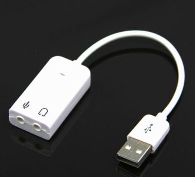

Not sure that the audio level from your proposed arrangement would be high enough to drive an EasyCap properly.
I suggest that you purchase one (or 2) of these cheap little USB Audio dongles on eBay. They are designed for the job (with power on the ring and signal on the tip), and the Portsdown is designed for them.
I bought 2 a few weeks ago from a UK seller and they arrived within a few days.

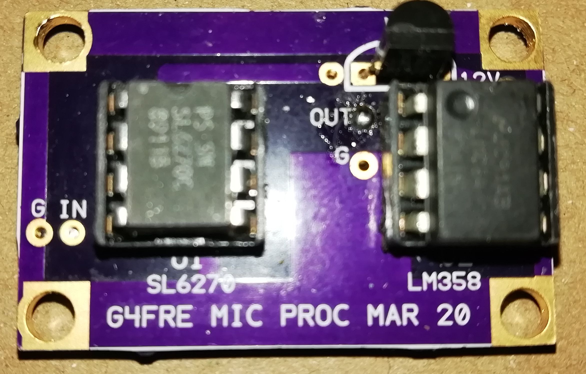

I experienced a similar issue with getting enough audio to drive the audiocap a few months ago. Then I came across G3AAF selling the old SL6270 vogad chip at the Swindon rally. G4JNT had published a circuit using that chip and an opamp to drive a PWM modulator in Radcom April 2013 page 40. All it needed was a dc blocking capacitor on the outputof the LM358. The only issue with the circuit is that the 4u7 capacitor across the 1M resistor needed to be a 47uF as per the datasheet (andy confirmed it was a radcom transcription error). Using my heil headset I did need the 2k4 resistor due to its high output. It worked so well I got a few PCB made and populated.
I subsequently discovered a 5.6GHz (non atv) use. It is an ideal circuit to generate enough audio to drive the FPV transmitters with enough audio to have decent voice qsos
G4FRE
G4FRE

Great idea Dave
What RadCom issue was that in? I have just found an SL6270C in my junkbox - now destined for my Langstone!

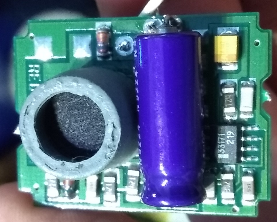

Had a look inside the mic assembly and found a lovely PCB with what I think is a low power single rail opamp 33171 https://docs.rs-online.com/a748/0900766b815744ea.pdf. The PCB has the motorola logo on the back so I'm assuming its exactly that, an amp, possibly with a bit of AGC in the circuitry. There are only two wires to it though, so I'm wondering how power and audio can go up/down the 'live' wire. Unless its like an electret, where the voltage drop via the feeder resistor IS the audio signal? So a bit like DC up the coax, only at audio. How to do THAT??
Be nice to use as-is. Worst case I suppose would be to change the feed wire to 3 core and add a specific 3.5 stereo jack suitable repurposed. The large electrolytic is 16V rated.
Thoughts??
Thoughts??
