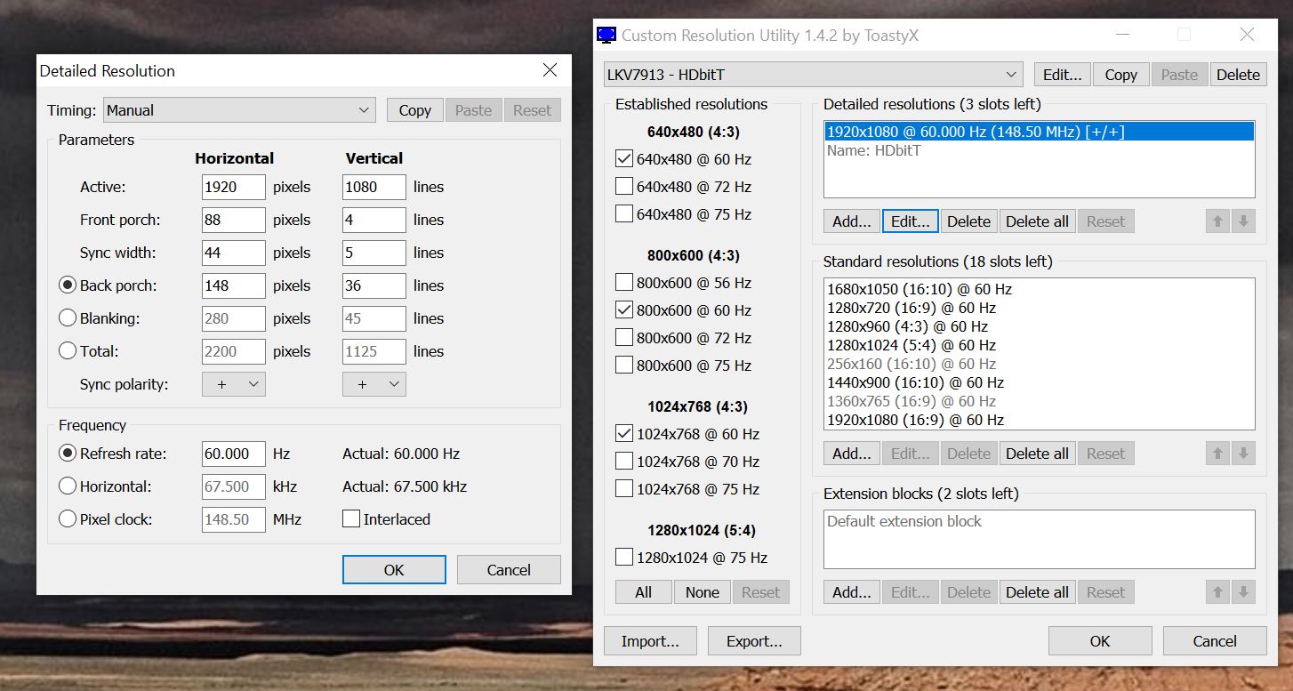

I run a Jetson Nano H265 encoder controlled by a Portsdown combined with LKV373 to convert OBS output from my PC for transmission.
For sometime I had been struggling to get the LKV and Jetson to play nicely and not drop frames / lock up.
I found that feeding the LKV direct from my 1080p camcorder that everything was much more stable and smooth.
Trying to mimic the same resolution and frame rate output from my PC video card led to dropped frames and video lock up - indicating there was something not quite right with 1080p output from the Nvidia video card.
I decided to try a custom setting on the video card and straight away noticed the HDMI front porch was set to 638 bits by default !
Using this calculator http://www.epanorama.net/faq/vga2rgb/calc.html I found on the web allowed me to tweak the PC video card front porch to 32 bits and in doing so greatly improved the stability and performance of the PC / LKV / Jetson combination.
I can now run 2Ms H265 at 1920 / 1080 24 fps smoothly for hours on end with no freezes or unwanted artifacts.
If you're having trouble with the LKV try checking your video card parameters and set them as per the calculator - it may just help.

That is interesting. I have gone over to using OBS Record to send UDP directly as the LKV373 stopped working altogether after a driver update.
Sending UDP directly from the PC can be a much better solution if you have a fast H265 encoder on your PC as it will also work with Portsdown and the minimalist PC+Pluto with appropriate firmware.
I will experiment. The LKV373 is still useful for cases where you don't have a PC with a hardware encoder, or have another HDMI source like a camera and need to get images to the Jetson Nano hardware encoder. There is a programme Custom Resolution Utility (CRU) that allows messing with parameters, but handle with care!

Post by G4WIM » Sun Nov 17, 2019 10:32 am
Hi Mike,
sounds like you had similar problems to me with the LKV being temperamental and sometimes just plain broken !
For a test I set a scrolling banner on OBS then watch the decoded video on MT for any jerkiness on the scrolling text.
Changing the front porch has removed all signs of stuttering on the scrolling text - not sure why or what the optimum settings are but at least in my case it has helped significantly.
Setting the front porch back to where it was causes the problem to re-appear so clearly at least with my set up there's something going on there, just not sure what or why.
