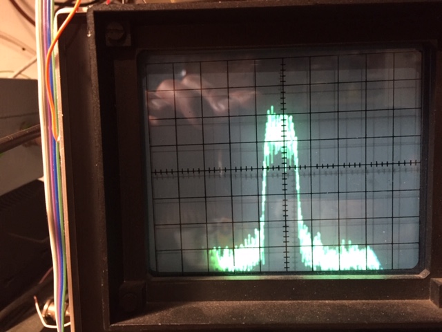

This is my Lime Mini, 2408 MHz, Lime Gain 85, 500KS. Image is 500 kHz/div, 10 dB/div. So at least 45 dB shoulders, but it's only a homebrew analyser....

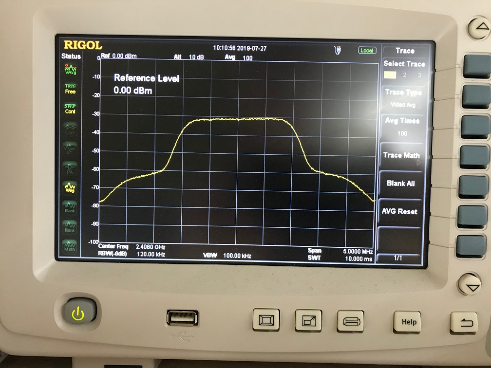

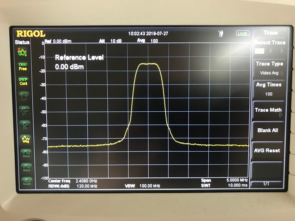

Hi Dave,
Good news I got exactly the same results as you at 500k but as soon as I increased the SR to 2MS the shoulders came up to -30dB.
Same results if I have the Lime directly on the RPI or via Jetson.
See attached pictures.
On the RPI I'm running Stretch 201906060, Lime reports FW version 6, HW version 2 Protocol Version 1, Gateware version 1 and Gateware revision 29.
Regards Tim
Regards Tim

Re: Lime Mini shoulders ?
Hi Tim
That is good news and explainable. At lower symbol rates, the RPi has the computer power to send the Lime more samples - giving it a better waveform/spectrum. At higher symbol rates, it simply does not have enough processing power, so it does not oversample. Here is the switching code:
The even better news is that Evariste and a colleague have been working on a custom FPGA build for the LimeSDR Mini (not the LimeSDR USB) that will allow 2 or possibly even 4 times upsampling at 2MS. I've been testing it, but there is a lot of integration work to be done to get it into the Portsdown.
