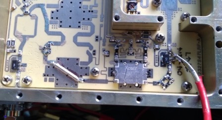

Thanks Mike, I've left the Spectrian for today and gone back to fault-finding my Stealth unit. Using a tiny two turn pick-up coil on the end of some coax to my Spectrum analyser, I sent drive in and followed it through. Seems both the pre-driver amps are DEAD so I removed the DC feed to the second unit and fed RF direct in there from my Pluto. Bingo, its working. I added one of the 5089 amp boards inline and hit 25 watts out, nice and clean too after the filter.
But it was cheap to start with...... Be easy enough to either replace each small amp (there seems to be some filtering and attenuation involved, repeatedly) or bypass the lot and use as-is with my little amp fitted inside somewhere handy.
Original Input bottom left hand side, new input red coax.

Well I think I have solved it :-) I removed the two dead driver ICs, added a pair of 78L05's on top of the 8 volt regulator elsewhere (marginal I know but 4.95v measured on load) and removed any previous feed resistors to the dead chips leaving just the PCB Inductance and a cap at the DC input point to ground.
From eBay I bought 10 of these https://www.ebay.co.uk/itm/10pcs-SBB-50 ... 2749.l2649 which appear in the little "DC-Daylight" amps sold on eBay but which I have found work all the way from 50 MHz up to 2.4GHz. Best of the bunch I've found.
I can now drive it to over 30 watts from my Pluto, so pretty much back to original spec or at least good enough for DATV.
