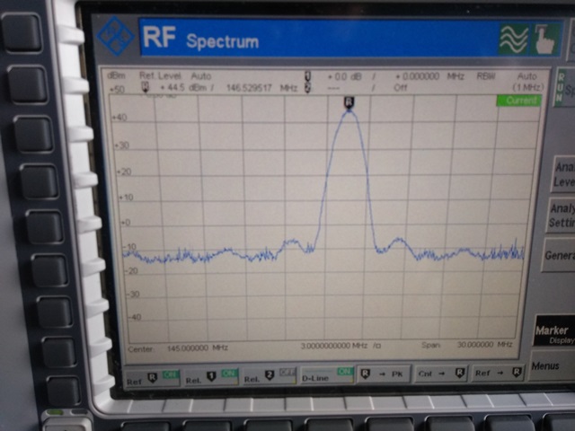

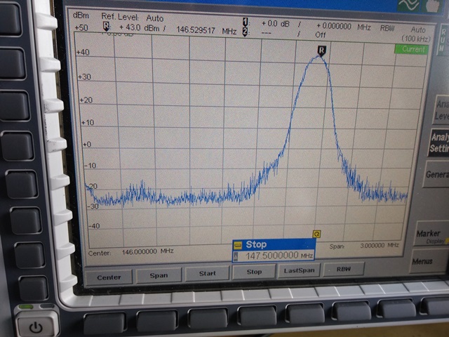

I've been experimenting now I have a proper power meter and spectrum analyser.
Using one of the cheap chinese VHF 100 watt amps https://www.ebay.co.uk/itm/100W-FM-VHF- ... 1776288254.
Driving it with Portsdown at 0% attenuation, one of these 'amps' (https://www.ebay.co.uk/itm/50-1200MHz-1 ... ctupt=true which are a single device on a reworked board - 2 watts dissapation maybe but not RF!) 125KS and tweaking the bias for power and symmetry, I get the attached waveforms and 44 dBm = 25 watts.
It looks 'good to go' to me or am I being hopeful? Gareth

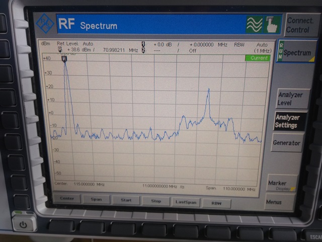

And the REALLY good news is that it seems to be happy on 71MHz too, delivering +40 dBm
Mind you, it might need a filter

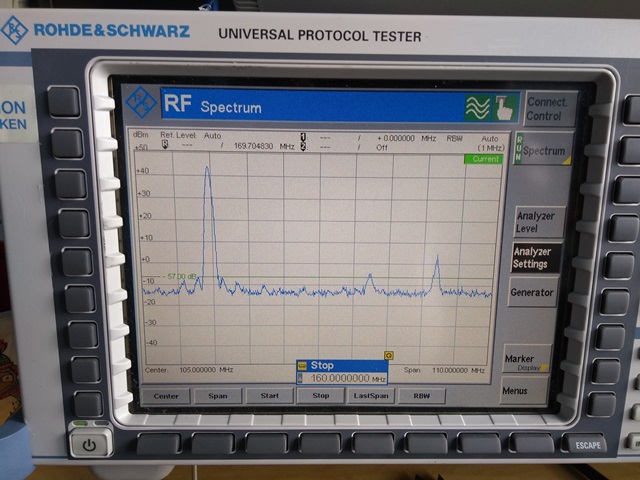

Sticking an open 1/4 wave of RG 174 on the output cleaned that right up. Amp draws 1.6 amps @28 volts so 45 watts in for 20+ out. Am I in cloud cuckoo land? Bias is 0.3 amp.
