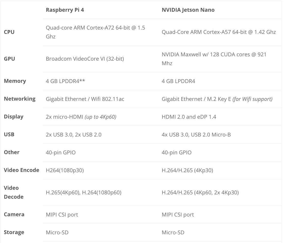

With the cost of the RPi 4 8Gb and the Jetson Nano being closer or the same now I thought it worth looking at this from a more technical perspective. My purpose here is a hardware and cost only comparison, I will leave the software portability of Portsdown, Langstone, etc to other with more knowledge and experience.
Here is a comparison chart of the RPi4 4Gb and the Nano... Note that the only upside on the Nano is the H.265 encoding and Maxwell GPU with 128 Cuda Cores. While these two elements could potentially make it the superior device for Portsdown it loses out on CPU and RAM.

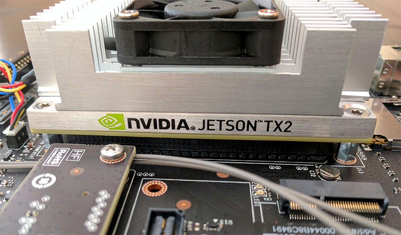

The Jetson TX1 is almost identical tot the RPi 4 4Gb with the exception of the NVIDIA Maxwell GPU with 256 CUDA Cores with a used price of around $30-$60 for just the module without the development kit board
The Jetson TX2, a used price of $50-$100 for the module alone without the development board, is the first real competitor from the Jetson family. It has all of the elements that make it a desirable device for our purposes of Portsdown, Langstone, etc and is becoming more affordable all the time...

It can be run as a stand alone module with a breakout connector, looks like an only Pentium3 block with heatsink and fan, or on a development kit board with all the connections easily accessible.

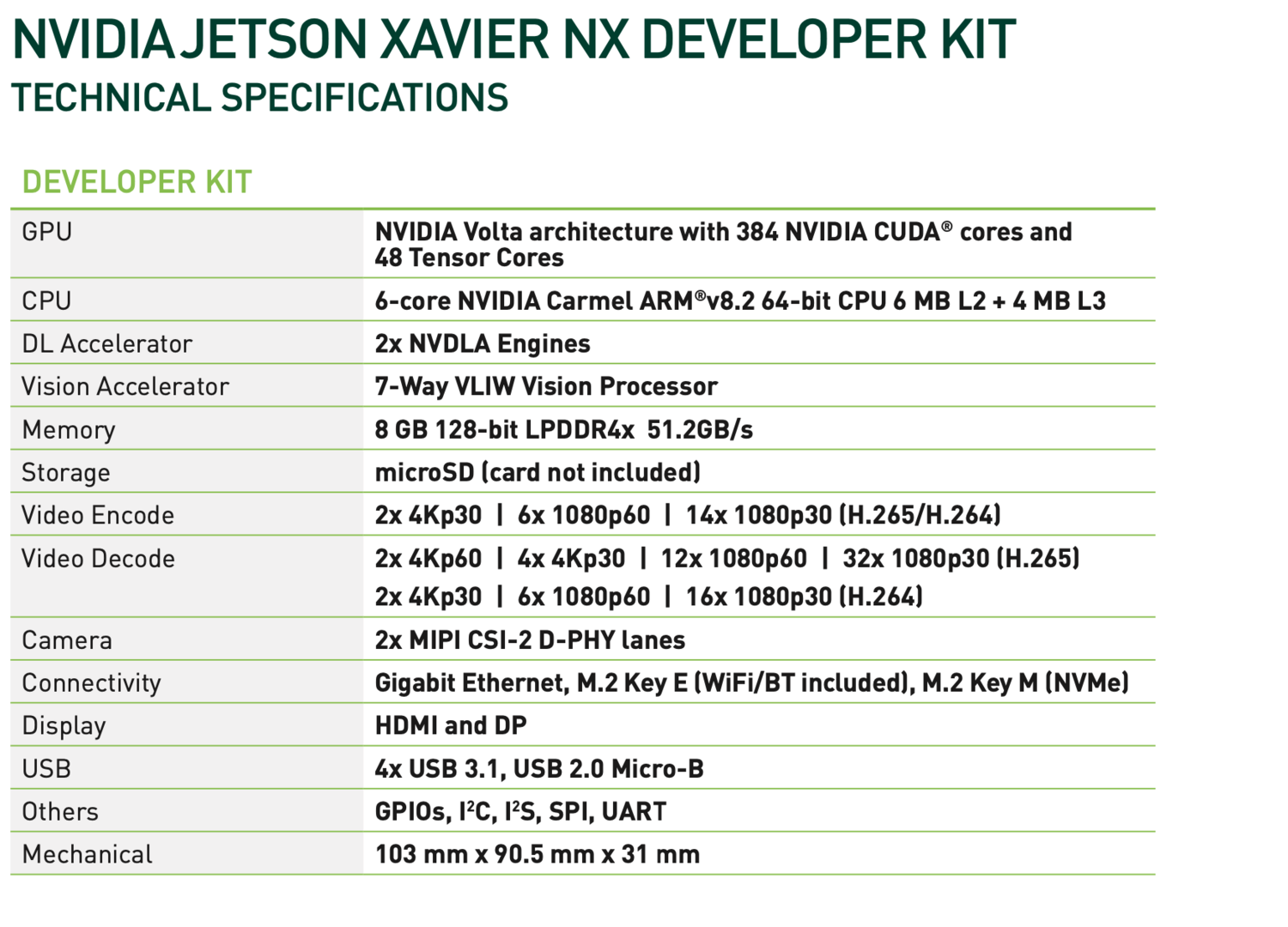

The serious Jetson family competitor, from a purely technical perspective, could be the Xavier (specs below) but at $399 it is not going to be a popular choice until it enters the secondhand market at half price or less.

You've missed a couple of points in your very useful analysis.
The Jetson Nano (I have a first generation one here) is excellent at hardware H264 and H265 encoding. It is a class above the H264 encoder on the RPi 4; this is its key strength. Its first weakness is that the drive capability and robustness of the GPIO pins is pathetic. They latch up if exposed to any electrical noise and can only sink/source a few milliamps. The second weakness is that it does not have a DSI port for connection of a touchscreen.
The RPi 4 is good at driving GPIOs and has a DSI port which supports an excellent (if expensive) matching touchscreen display.
Memory is not an issue for the likes of Portsdown - it uses well less than 1GB when running.
The Porstdown does support control of a network-connected Jetson Nano (see the slightly out-of-date guide here https://wiki.batc.org.uk/Jetson_Nano). This is the system that I use for my QO-100 transmissions.
