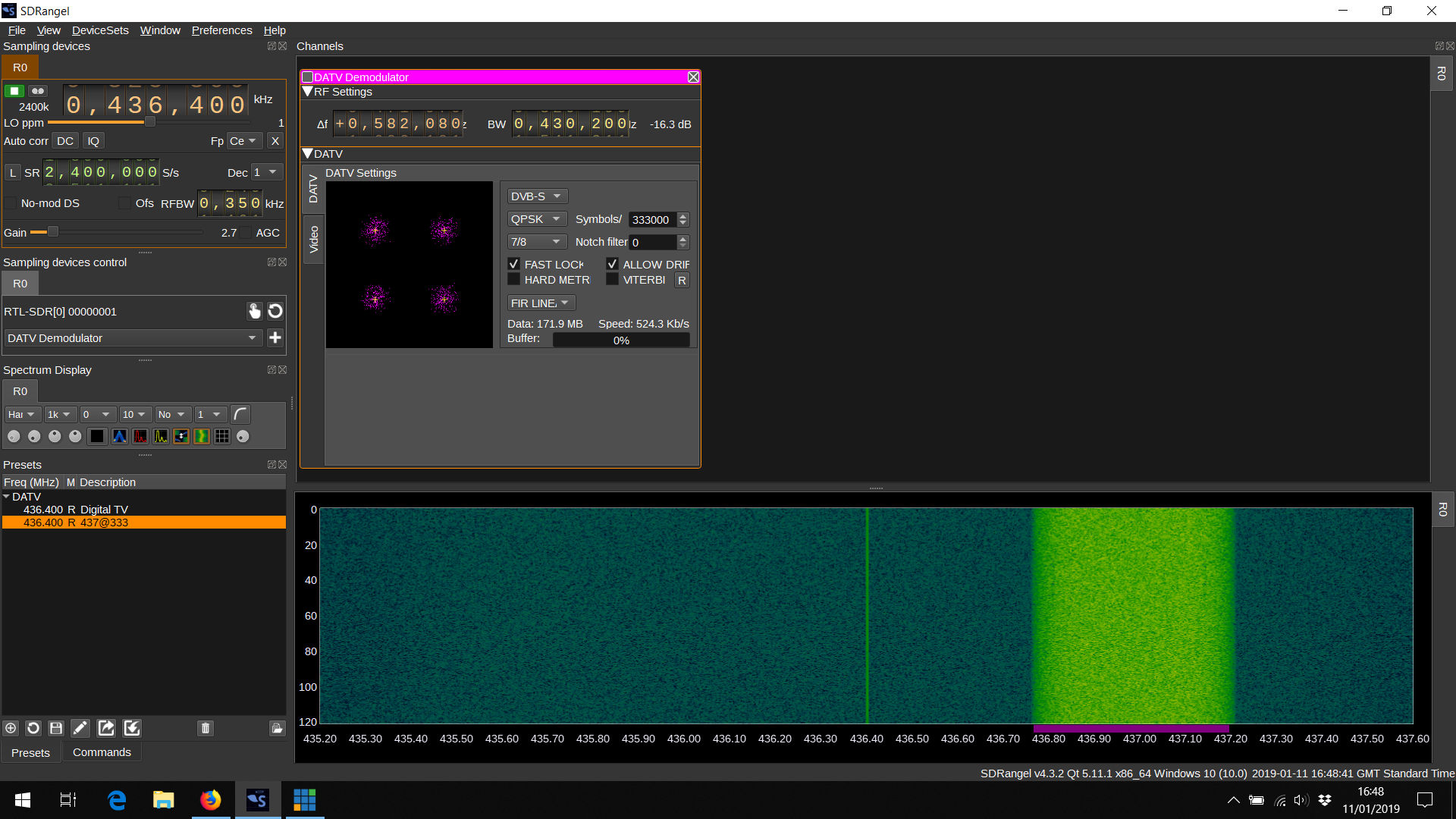

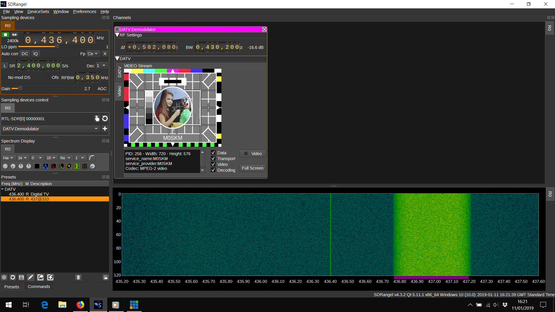

Following the link on BATC facebook I've had success receiving my DATV signal through SDRangel. Real pleased that I found a use for my RTL Dongle.

Hi Steve,
Looks good - can you repost the link as not everyone is prepared to use Facebook - I only do it very reluctantly for a variety of reasons!
BTW - do we know if they have implemented Veterbi decoding - if so that makes it better than LeanDVB.

OK Noel here are some long links.
You need this download of SDRangel as it includes the DATV plugin.
https://github.com/f4exb/sdrangel/relea ... PH1Pf1wQTU
Here is the instruction video posted on YouTube by Corrosive. LOL
https://www.youtube.com/watch?v=Bb8S_J9 ... 4O0wPQCQSE
Below the video there is a batch file needed to set the path to ffmpeg. Note the path is C:/ffmpeg not the standard C:/ffmpeg/bin
The plugin does have Viterbi but it warns that it's processor hungry.

I had an issue with Corrosives batch file in that it did not seem to add c:\ffmpeg to the path.
Having just looked at the setx command I think it sets it in the registry which may then involve a system reboot.
Instead I just used the following command in a Dos/cmd window
set path=c:\ffmpeg;%PATH%
This puts it at the beginning of the path table.
Oh im using Win7 64bit.
Hope that helps

Yes it works OK Shaun; tried it last night.
