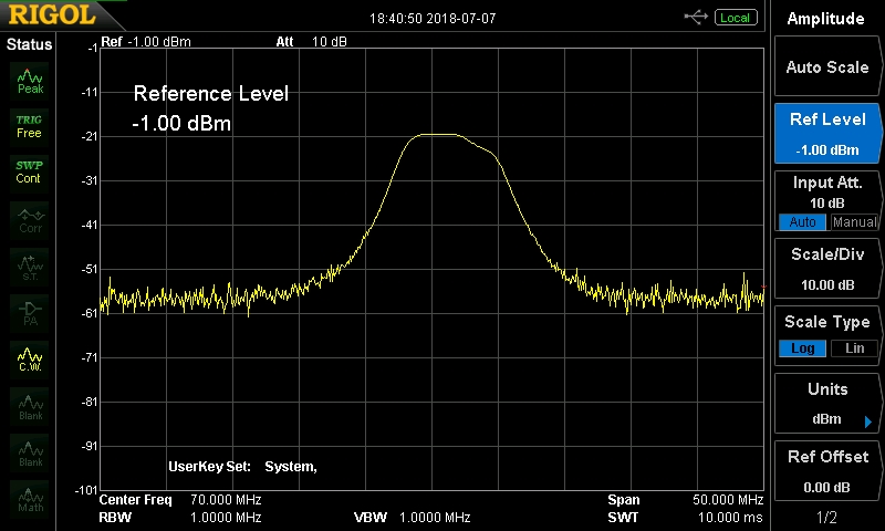

Much to my surprise, it has enough gain to go to full output with the Express without the need for a further driver amplifier. The picture below shows the shoulders at 10W, -35dB (power measured with 100-250MHz Bird slug).
The low pass filter in the output stage is doing a good job, with only the second harmonic at -55dB visible up to 1.5GHz. This is at 20W output, shoulders -30dB. I pushed it to 25W, but it was getting a bit wide there! I think 10-15W is a reasonable level for this amplifier.

As on 146MHz, -35 dB shoulders are a bit high as they fall outside the 70-71.5MHz range at 333ks, which can be seen from your photo if I am reading it correctly. I would suggest reducing the power or symbol rate so that signals above 71.5MHz are at least 60dB down. How much do you get out with -50dB shoulders?

At 14 Watts the shoulders are 35dB down; It's the same PA block but I bought the complete kit from Minikits. It worked well at 50MHz when we did tests a couple of years back.
Initial testing at 71MHz was with the Portsdown driving the PA via a filter only. I have since used the "Portsdown Express" to drive the PA with a much tidier constellation.

DATVexpress with Portsdown UI in to same brick gives about 12 watts with 40 dB shoulders.
