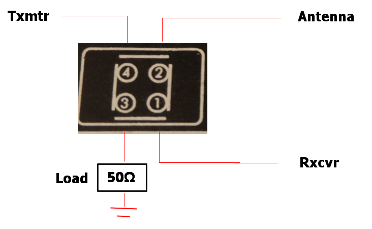

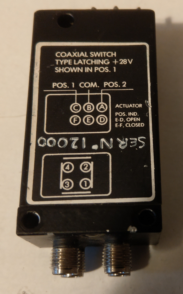

As above, the relays shouldn't be too difficult to source. I got this 18GHz one from a Rally last weekend for £20. (about $25), nearly all the ones I saw were 28V, that seems to be the standard (odd voltage.. anyone?).
I haven't had time to play just yet so I'll find out what voltage will be needed to throw it over and I'll probably cheat and simply add an extra small battery (or two) trickled into a Capacitor which can be used to provide a -16V supply (to the common pin) while 12V is applied to the switching pin.
The way the changeover contacts work is shown on the side, It seemed sensible to add a tiny 2W 50R SMA dummy load to the empty pin, which will be connected to the Txmtr during Receive and to the Rxcvr during Transmit.
On this one there are also some extra contacts which will indicate the actual position of the relay contacts, 1 side might also be used to trigger the power to the Txmtr which will add a small mechanical delay after the RF contacts change to Tx.[/color

In case anyone wasn't aware, the style of relay pictured above in Wolfie's post is known as a transfer relay.
It's probably worth keeping an eye on eBay for these, and for 3-port 'changeover' relays as they do often appear in voltages other than 28V. I managed to pick up a handful of 8V ones - which are great as you only need a series resistor for 12V operation - and I have seen both 12V and 6V ones over the last 12 months.
