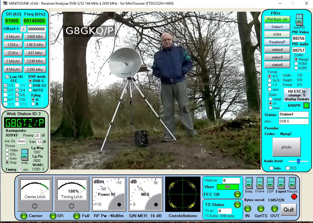

Initial tests gave good results on narrow band (with a fairly pure tone from the Bell Hill 24 GHz beacon) but MiniTioune would not achieve a lock on DATV signals. I then applied the modifications detailed in this month's ScatterPoint to reduce the on-board power supply noise, and also enabled the clock doubler and increased the charge pump current as suggested by G4JNT. Both these modifications were needed to reduce the phase noise to an acceptable level. The effect of the noise can be seen on the received constellation plot below, with the elongated quadrant responses. The effect of the noise seemed relatively independent of SR; it has similar effects at 333KS and 4MS, but I suppose that depends to some extent on the noise spectrum.
