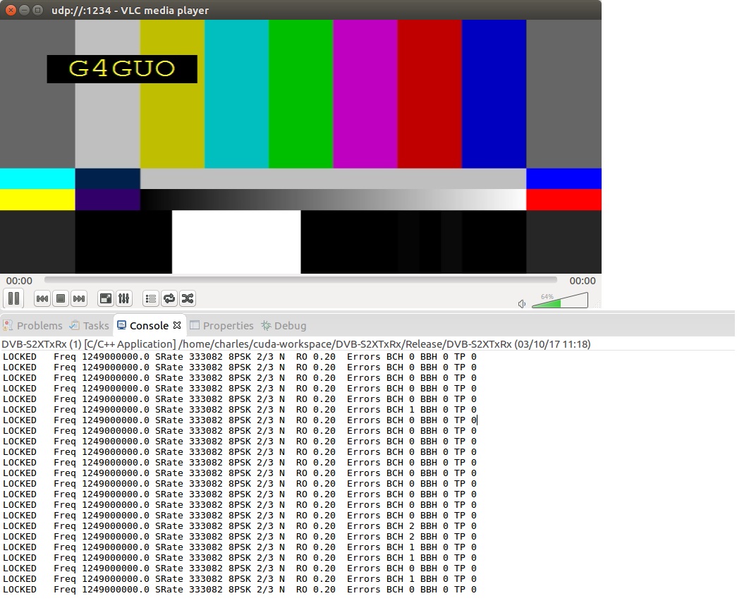

I thought I would share my initial work on DVB-S2 decoding in software.
It is of little practical use as it requires an expensive NVIDIA graphics card
to do the FEC and currently it only operates at <= 333 KS/s.
To transmit I was using DATV-Express and to receive ADALM-PLUTO
Screenshot from 2017-10-03 11-20-57.jpg (298.74 KiB) Viewed 10238 times

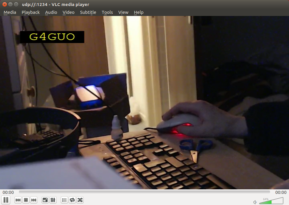

Wind was obviously blowing in the right direction tonight.
Transmitter DATV-Express running on Windows, Receiver ADALM-PLUTO running on Linux
Software demodulation of DVB-S2 32APSK FEC= 9/10 approx 1.48 MBits/s
Screenshot from 2017-10-24 22-49-21.png (190.73 KiB) Viewed 10011 times
Screenshot from 2017-10-24 22-28-45.png (599.19 KiB) Viewed 10011 times
- Charles
