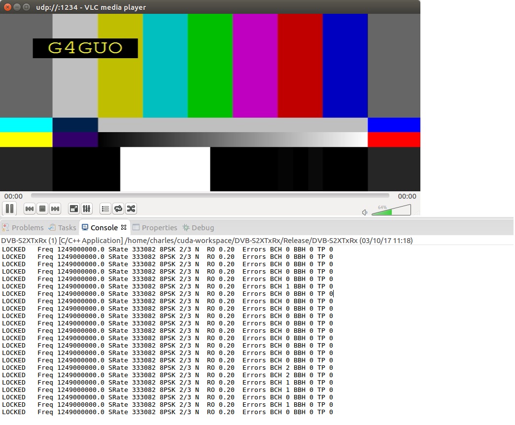

I thought I would share my initial work on DVB-S2 decoding in software.
It is of little practical use as it requires an expensive NVIDIA graphics card
to do the FEC and currently it only operates at <= 333 KS/s.
To transmit I was using DATV-Express and to receive ADALM-PLUTO
- Charles

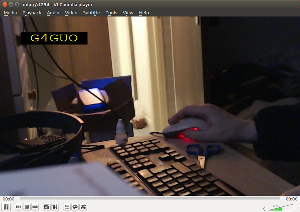

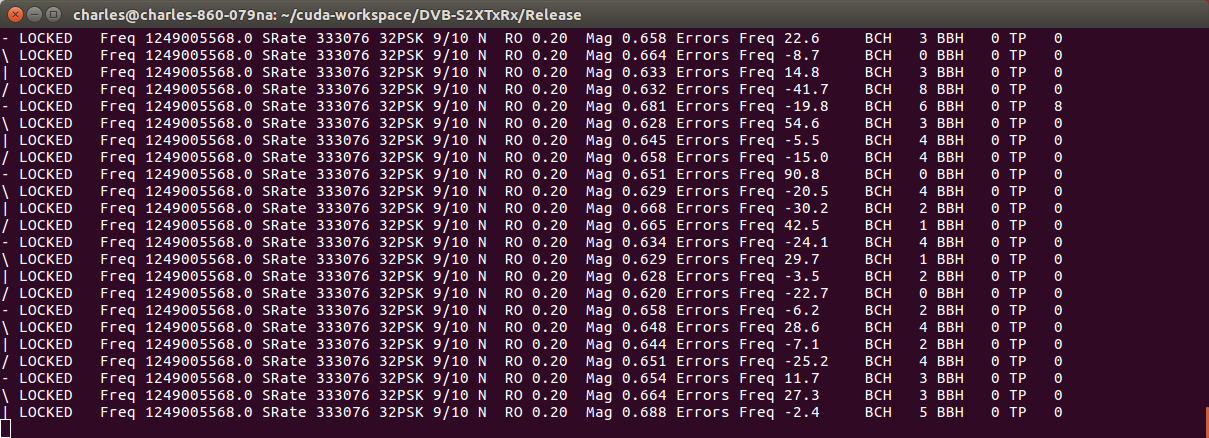

Re: Linux based decoding of DVB-S2
Wind was obviously blowing in the right direction tonight.
Transmitter DATV-Express running on Windows, Receiver ADALM-PLUTO running on Linux
Software demodulation of DVB-S2 32APSK FEC= 9/10 approx 1.48 MBits/s

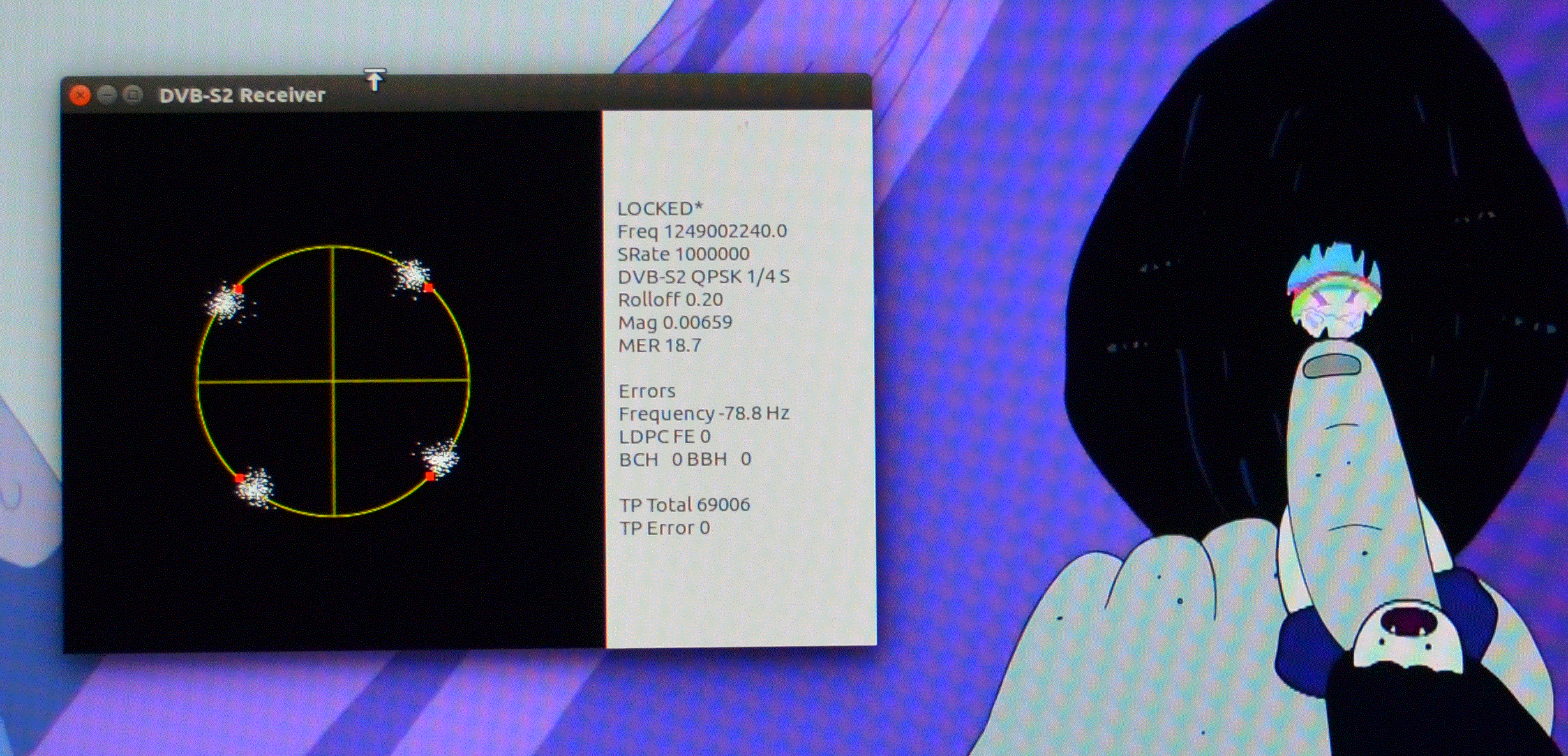

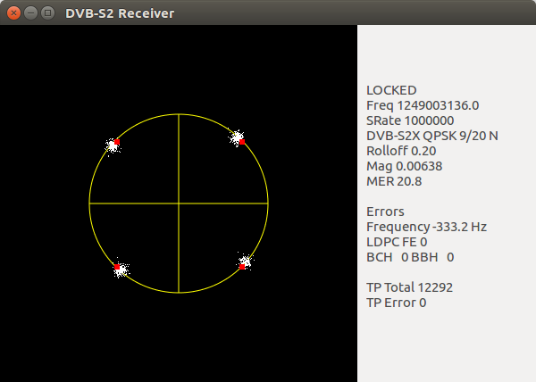

The soft modem can now claim to be able to decode DVB-S2X
however there are almost 100 modulation formats in DVB-S2X
