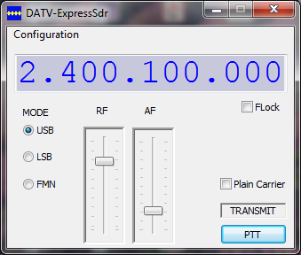

Re: DATV-Express SSB / FM Radio Transmitter
Do you mean an application like (which only runs on Express Hardware)?
- Charles
Yes Charles, I use that software you showed in your reply and I always a carrier with my modulation.
I suppose that it will be more convenient to send suppressed-carrier ssb modulation to Es-Hail sat.
Thank you.
Thank you.

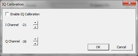

I see, the carrier is due to imbalance in the I and Q being sent to the modulator,
to get rid of it a calibration routine would have to be added like the
DATV-Express software has. The SSB app does not have one.
Because DATV-Express is transmit only it is necessary to use a receiver
to monitor the carrier while manually adjusting the I and Q.
I suspect very few people bother to use that when sending DATV.
- Charles
Yes you are right but here I just want to use my datv express board for both usage (datv and SSB).
It will be very useful if you could add the IQ calibration functionnality to your datvexpress sdr software.
Do you think it is possible for you (I mean in your freetime) ?
Michaël ON7KGK
