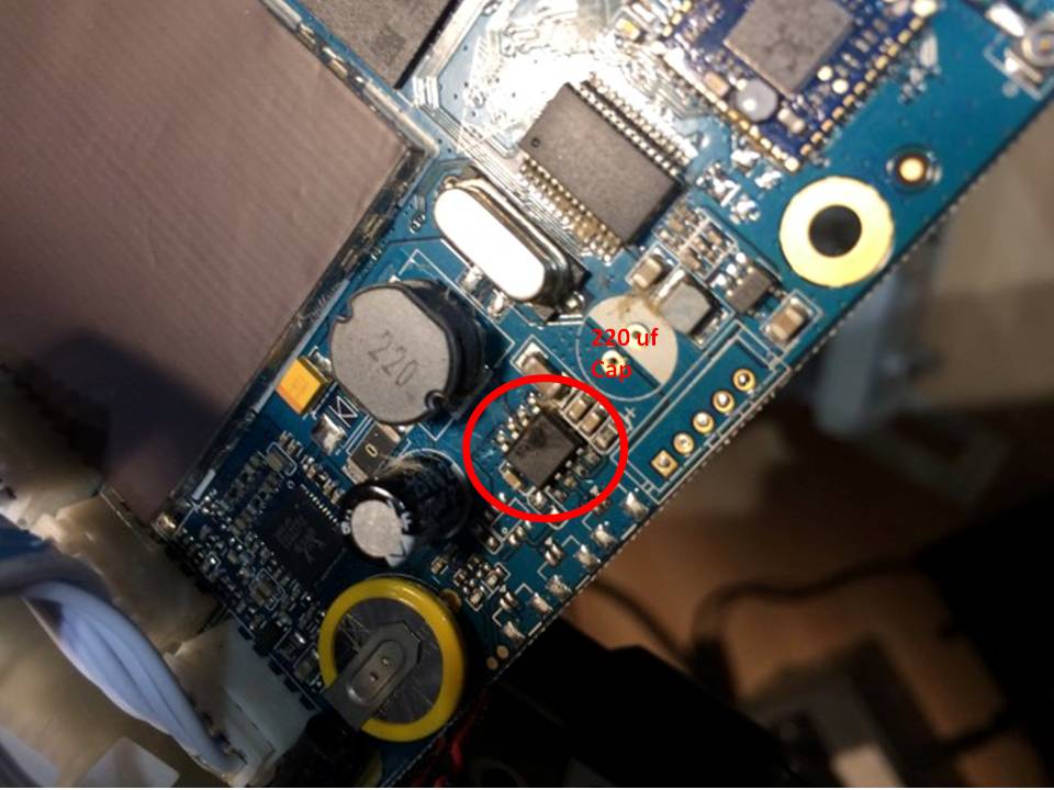

Due to confusion with red and black wires during the activity weekend, my Pipo8 went bang :-(
To start with, it looks like it took out a 220 uF capacitor and what I presume is a low voltage regulator IC seem to have suffered but I can't read the part number as it's brown and charred :-( - see the picture.
pipo damage.jpg (77.47 KiB) Viewed 6873 times
Is anyone willing to take the bottom off their Pipo and drop the main board (just 4 screws and the wifi aerial connection) and see if you can read the IC part number.
Thanks in advance

On one line it has "1930" and on the line below "3314563". There's no manufacturer's logo.

Semtech 1456 might be it but seems too old (2000)

Seems like too small a package. How about:
http://www.mouser.co.uk/ProductDetail/M ... MAX1930ESA
Which pin is the ground on?

It's a DC-DC convertor chip, mine has exactly the same markings and no manufacture logo.
pin 4=Ground
Pin 1,2 go to the large inductor, as far as the rest not really sure!
There's an LT1930 but it does not show up as so8 package....

Is anyone willing to measure the volts on the inductor / 0 ohm / 220 uf capacitor, all of which I presume are on the output of the switched regulator?
Once I know that I can rig up a supply and test whether everything else works before trying to find a replacement
Thanks in advance.

There's 5.1v on the 220uF nearest the battery. The other 220uF has 12v on it - presumably the power input.
