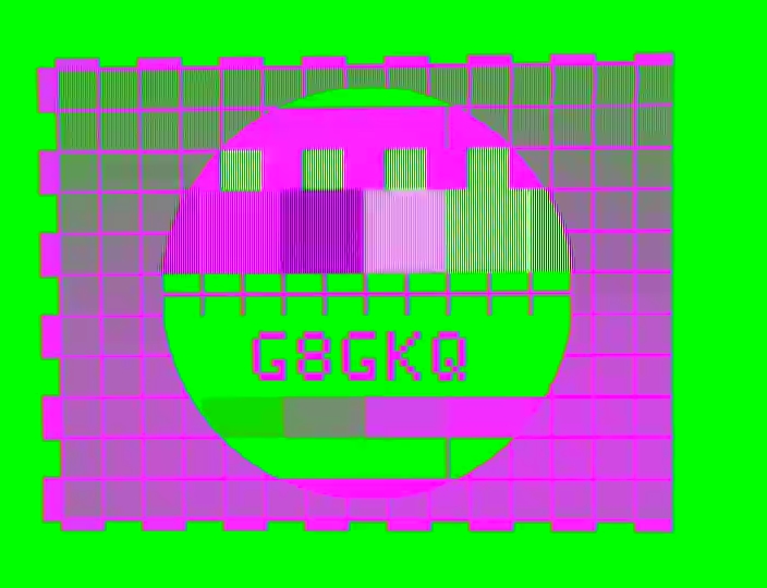

I'm still struggling with my capture device. Here's the picture that I get
EasyCap Problem.JPG (147.33 KiB) Viewed 11659 times
and this is the device configuration:

I've tried both inputs, and it does work on Win10 with VLC. Maybe it's incompatible - or does it just need a configuration change?

I have two identical looking EasyCap dongles.one gives me exactly the result you are getting but the other one gives a perfect monochrome picture.
Both of these devices work correctly in Windows programs.
I have not yet managed to sort out how to run the script to put the grabber into PAL mode before Rpidatv runs. My computer skills are poor but it is a challenge and I will keep trying and report the results.
Arthur G4CPE
