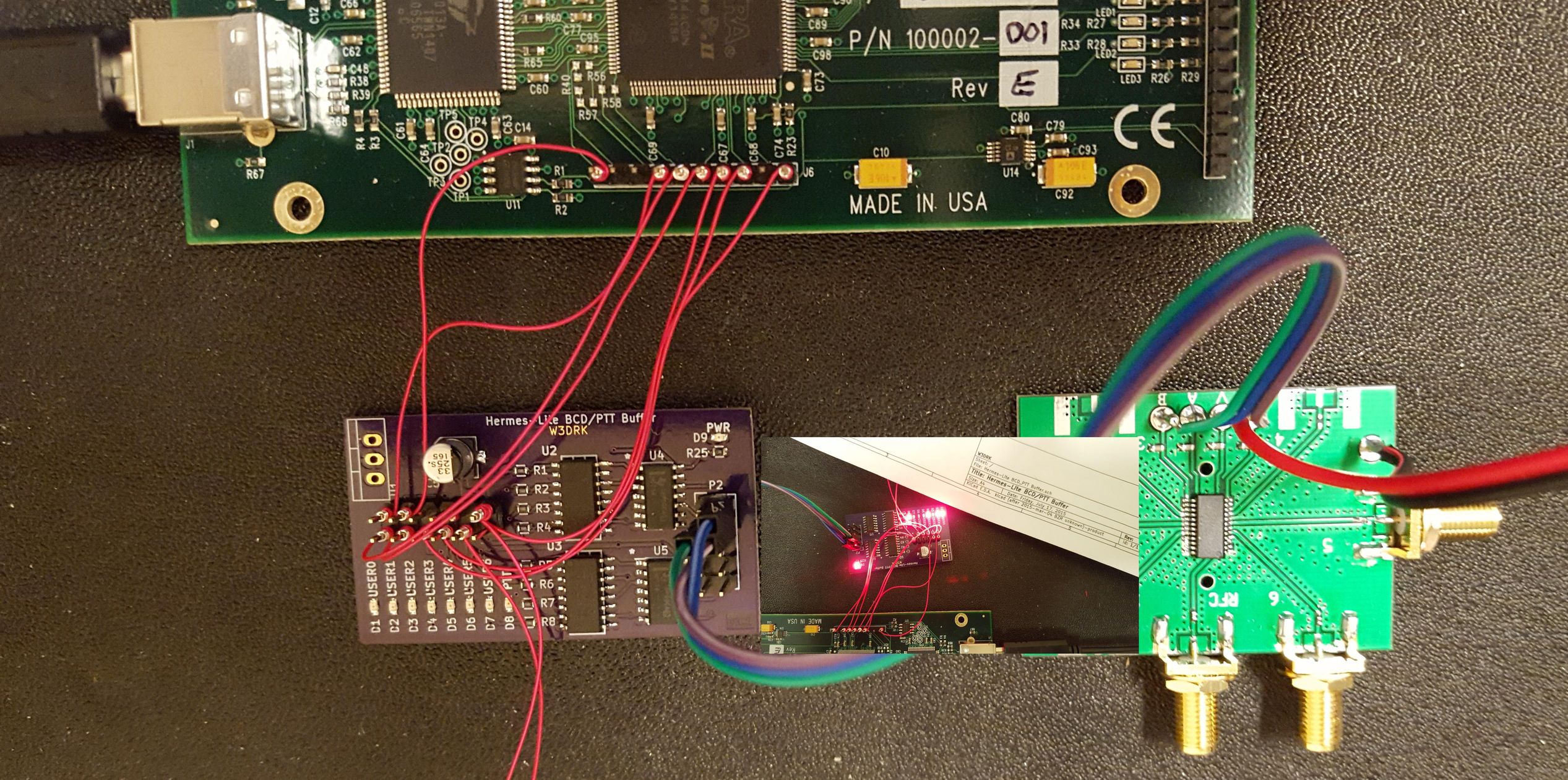

I have been playing with the port selection and sequencing of the PTT and C/O Relay lines in V1.11.
I found that the timing of the PTT signals on J4 - pin 2 and on J6 - pin 3 are not the same.
When going into Transmit mode the PTT line, on J4 - pin 2, rises at the same time as J6 - pin 4, C/O Relay line.
Then when returning to Standby, the PTT line, on J4 - pin 2, falls at the same time as the PTT line on J6 - pin 3.
Not sure if that is a bad thing or not, it might be a useful feature in the future?
Just be aware that the timing of PTT on J4 - pin 2 and J6 - pin 3 are not the same.
There is a warning in the release notes.
"These pins are connected directly to the FPGA with no protection you have been warned."
I found, on OSHPark, a PCB designed by W3DRK to interface to the Altera FPGA DevKits used in the Hermes-Lite project.
It has eight opto-isolated lines and an inverted PTT output line for systems that need it.
On the bench the outputs from the opto-isolator board control an HMC252AQS24 six way RF switch.
Thanks Charles, please can we have an "Apply" button, on the Modulator settings window, in the next release?
Opening and closing the Modulator settings window gets old after awhile when testing.
Dave - G0EID

Hi Dave,
Yes J4_2 is the old PTT line. I left it as it was before for backward compatibility.
I still have to tweak things so that the RF output is sequenced as well, at the moment it is not
and could cause an issue. A better solution would probably be to do the sequencing in external logic.
That is what I currently do myself (using a cheap FPGA board, the one I wrote an article about
a few years ago in CQ-TV) but a PIC or plain logic would be just as good. I know a number of
people have developed sequencing boards mainly for use on microwaves and on moonbounce.
Interested in the HMC252AQS24 six way RF switch, where did you get the PCB from?
I picked up some latching selector switches recently good to 26 GHz but they are a bit
overkill for this application.
