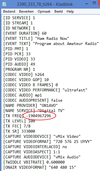

With version 1.04 I observed the following:
- less stable, short "Not responding" error after selecting another config file
- negative TX frequency in the config file after configuring, saving and restart
Datv Express v1_04.jpg (240.04 KiB) Viewed 9644 times
73 de ON1AVO
Freddy

Thanks for letting me know.
I have not been able to re-produce it but I am aware of a potential issue in 1.04.
(a variable that is updated by multiple threads was not being protected from simultaneous access).
I have corrected it in my current development version (which I plan to release
when I have updated the notes file).
- Charles
