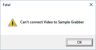

- Start: errormessage, after OK, Express Transmitter window
Afbeelding 001.jpg (22.55 KiB) Viewed 11119 times

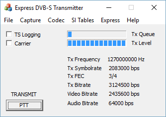

Afbeelding 006.jpg (69.5 KiB) Viewed 11119 times
o Tx Queue: empty????

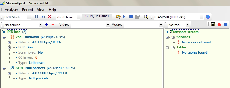

o No video output, explation, see TS analyser screenshot
Afbeelding 007.jpg (130.28 KiB) Viewed 11119 times
Just all stuffing Null packets.

Post by G4GUO » Tue Feb 09, 2016 10:04 pm
You need to select a video format
640x480 30 fps RGB24 for the C920 as input
or 720x576 25 fps if you are using vMix output
The sampler can't connect to the video source as it doesn't know
what format the samples are in. Consequently no video is being
transmitted.
Once you have the initial configuration done that problem should go away.
Those Tandberg receivers require a perfectly formatted DVB signal so you may have
problems. Modern receivers are better are coping with out of spec signals.
- Charles

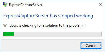

It works! This is my experience:
After changing configuration files and press PTT:
DATV-Express crash.png (7.09 KiB) Viewed 10808 times

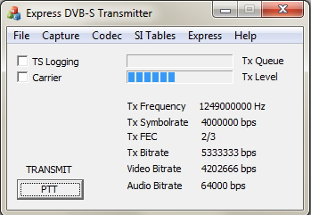

After starting the application it works:
DATV Express ok.png (10.63 KiB) Viewed 10808 times
I had one crash and was not able to start app and had to reinstall the program. After reinstall and reconfiguring everything is ok! I'm using VMix....

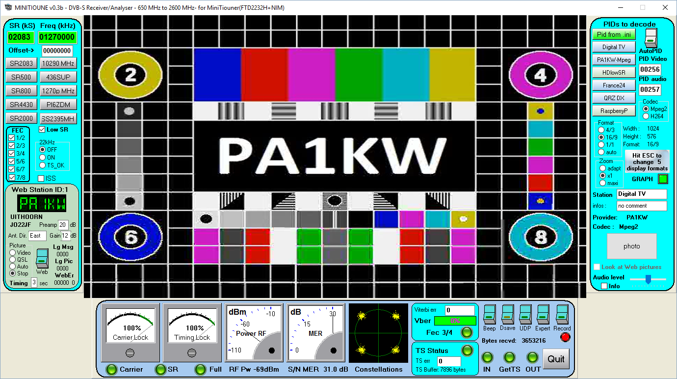

PA1KW DATV Express.png (598.68 KiB) Viewed 10808 times

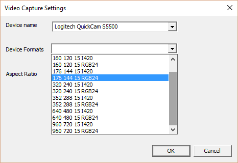

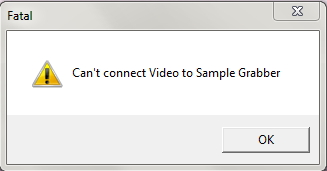

I did try to use my Logitech Quickcam S5500, but i'm receiving the following message:
sample grabber error.png (4.73 KiB) Viewed 10807 times

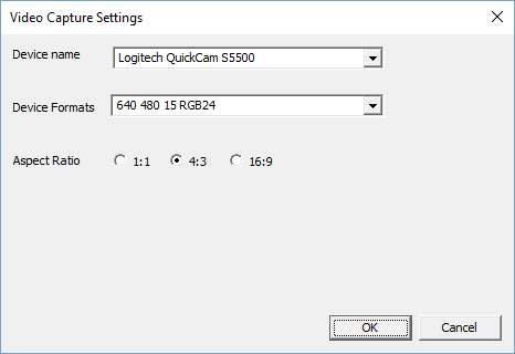

This are the video settings:
Video Capture settings.png (7.77 KiB) Viewed 10807 times
73 Koert PA1KW
G4GUO
Posts: 736
Re: DATV-Express Project - January update report
Post by G4GUO » Thu Feb 11, 2016 4:44 pm
Hello Koert,
Glad to hear you are having some luck. The program is not very good
and starting on a system it does not know about hence the original crash.
During tests with GB3KM it was found the repeater only likes PAL frame rate
and resolution images so I put a filter in the code that would have rejected
your 15 fps camera. Hence the reason you get the message. If you had selected
a 640 x 480 30 fps device it probably would have worked.I guess I should
add a message that says something like "No suitable video capture device selected".
I stretch the image from 640x480 to 720x576 in software. KM thought the
original image was NTSC (we think).
- Charles
