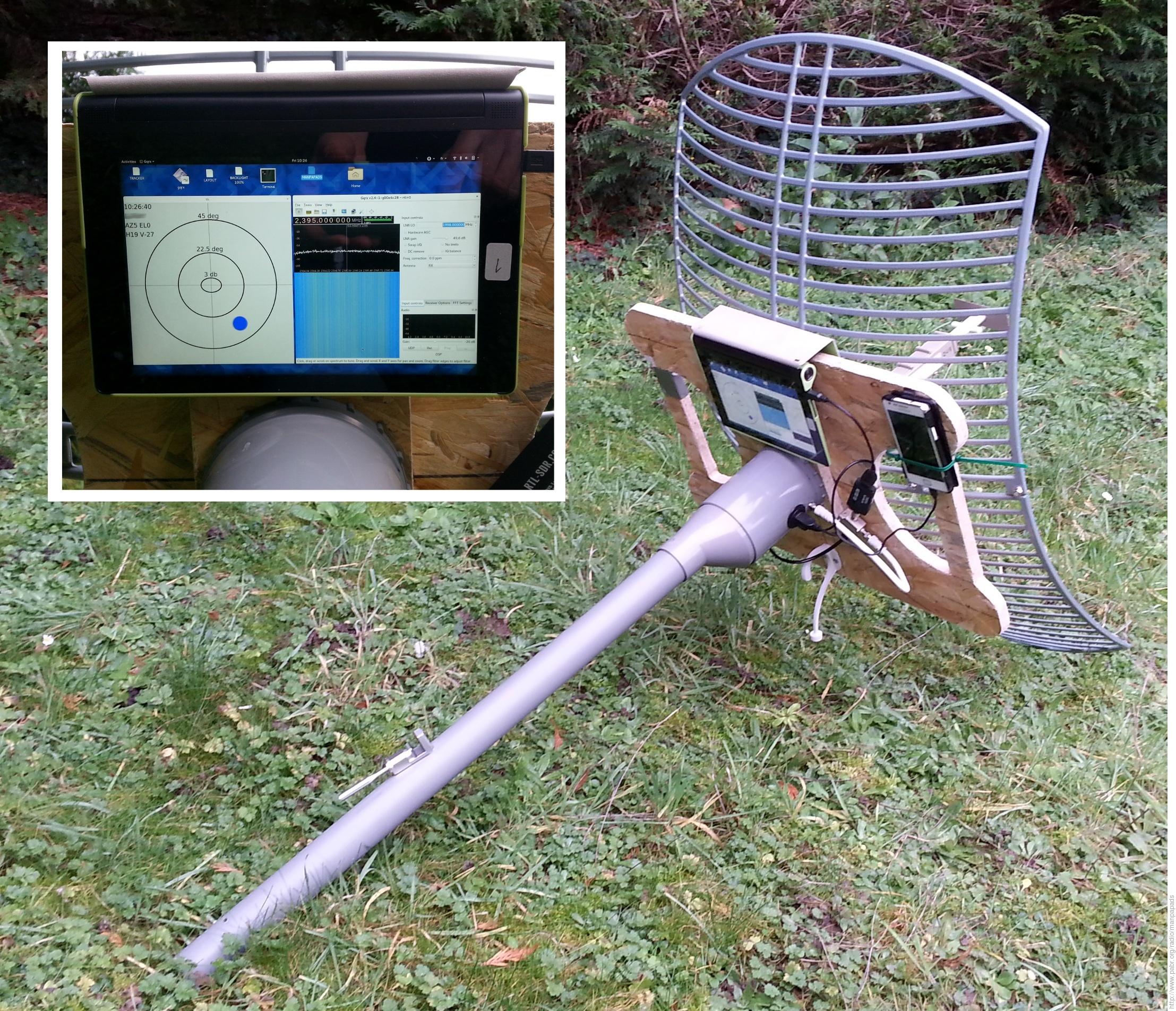

FYI here is the shoulder-mounted receiver I tested this morning during the Sandringham School contact. This is the current state of my project to build a HAMTV receiver for about 50 EUR (plus a smartphone).
Actually I was only able to finalize the software late last night, and the transmitter was offline earlier this week anyway, so everything failed miserably this morning due to lack of preparation and testing. I am not sure whether video was used during this contact, but I was hoping to at least catch the blank transmission despite the poor elevation (56° from Paris, France). Hopefully I will be able to announce a successful reception in the next few weeks.
P.S. I would like to thank all the amateurs who have been working for years (since 2002, I think) to make HAMTV possible. The technical challenges definitely revived my interest in amateur radio.
- 24 dB WiFi dish (100x60cm)
- MMDS downconverter (LO 1998 MHz) with built-in linear dipole (I know...)
- DC bias tee and 14.4 V battery pack
- rtl-sdr dongle with R820T2 tuner and TCXO
- scrap construction materials
- Linux tablet.

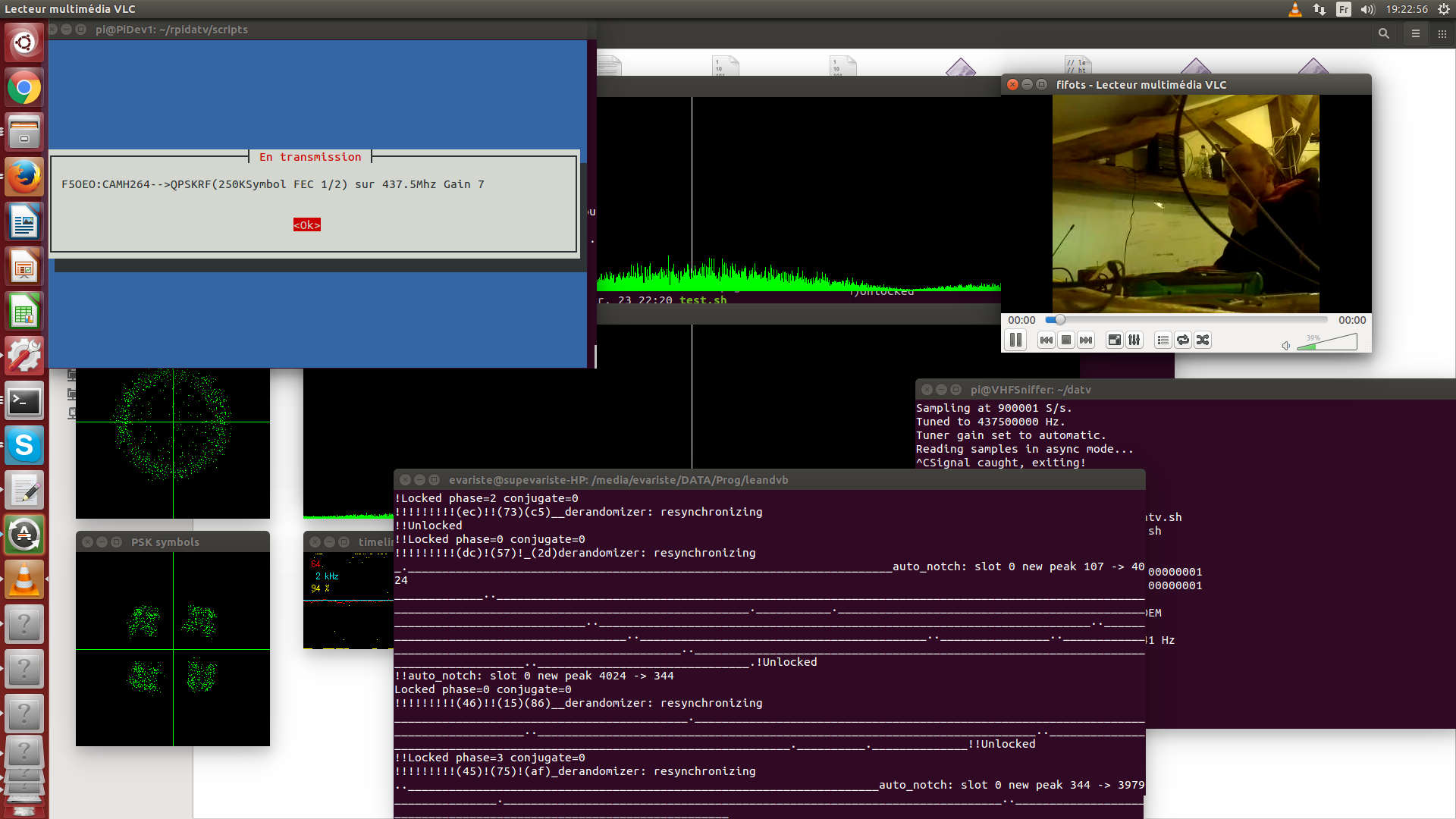

Re: ISS reception with RTL-SDR
Successefull working leandvb receiving SR from 1M downto 250KS without any problem.
CPU on PC is about 20% on a live stream at SR 250K.
Receiving RBDATV from 30MHZ to 1.8GHZ is now possible with just one cheap RTL-SDR usb dongle !
Hope that in a nearr future we can run it on Raspberry Pi which then will be a complete RBTV receiver with embeded MPEG-2/H264 decoder.
Thanks for this great work Pabr.
It very nearly works for me but I just can't get it to lock with my RTL-SDR.
If you have a clean signal (ring-shaped I/Q plot as in F5OEO's screenshot), possible problems are:
- Oversampling is too high. Try 2.4 Msamples/s for 2 Msymbols/s, or 1.2 Msamples/s for 1 Msymbols/s, etc. This is a bug; will be fixed in the next version.
- Tuning is off by more than 5% of the symbol rate (e.g. +-100 kHz for 2 Msymbols/s). rtl-sdr dongles with a TCXO are recommended, but some downconverters introduce large errors anyway. You can estimate the offset visually or with a tool called kal-rtl (or kalibrate-rtl), and provide it with "leandvb --tune HZ".
- Modulation is not supported (currently QPSK only).
- Out-of-band interference within the spectrum captured by rtl-sdr. To save CPU, leandvb does not bandpass-filter the signal, therefore nearby transmissions will be picked up. This should be obvious in the top spectrum plot. Again the solution is to reduce the rtl-sdr sampling rate.
- In-band interference. Leandvb does not equalize the signal either. However, it does try to remove birdies (a common problem with rtl-sdr dongles). Ideally the bottom spectrum plot should be free from persistent spikes. By default leandvb tracks only one birdie, but you can start it with "--anf 2" or more. Also, shifting the rtl-sdr tuning frequency by a few kHz sometimes makes the birdies go away.
