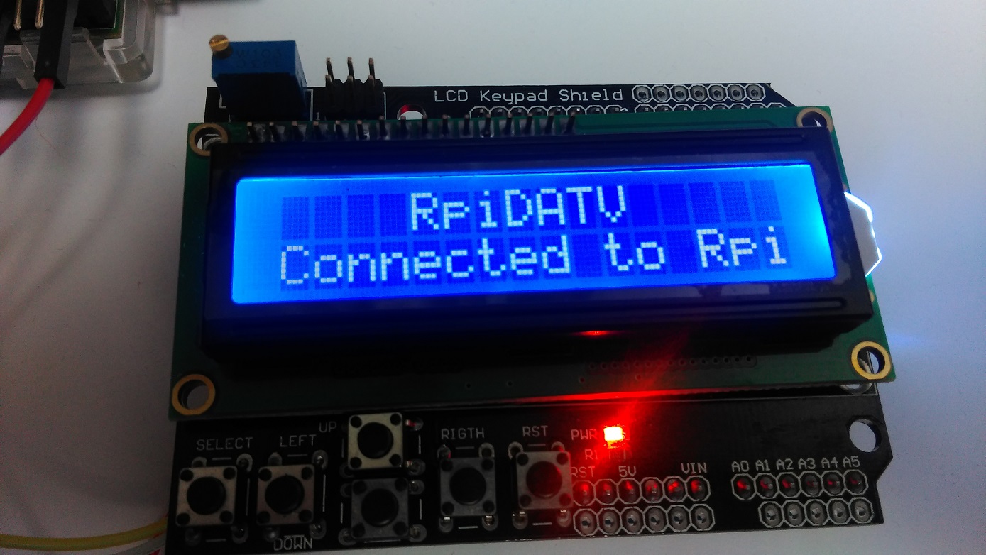

First test today ..... it works!
Many thanks Alain
Con to Pi33.jpg (261.68 KiB) Viewed 9808 times

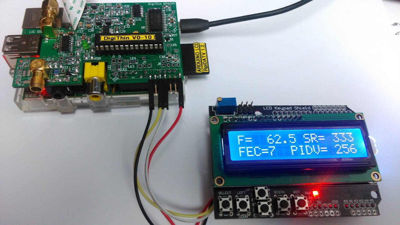

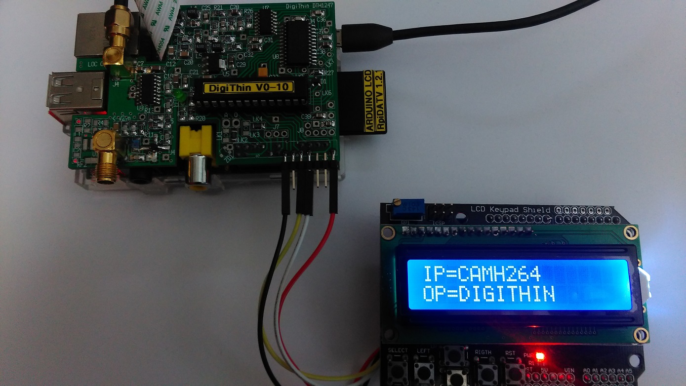

Post by G4KLB » Sun Sep 06, 2015 12:26 am
Good progress today, have had the DigiThin transmitting with the settings from the Arduino.
The only problem to resolve is it stops transmitting after around 50 seconds.
Have disconnected the Arduino after it starts but still stops after the 50 seconds.
Have been testing with a clone Arduino Uno R3
Colin
