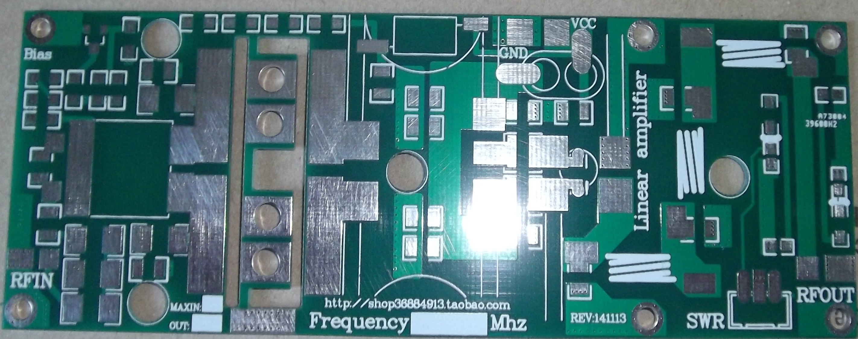

Has anyone had a similar experience with these Chinese kits.
I ordered a UHF amp and when it arrived I thought great 28 quid what could go wrong.
Well, just about everything, it was the wrong kit, it was a VHF board, half the bits were missing, none of the SMD parts were identifiable, the MRF186 was attached to a bit of secondhand pcb, they did put it an anti static bag bless em, no circuit and no instructions.
After about 20 emails backwards and forwards no chance of making them understand they had supplied the wrong bits, so I gave up.
Be aware if you buy these kits be prepared for a bit of work.
Some pics for reference.

I bought one of those kits (VHF version). I have not had time to put it together but a BATC member emailed
(Dave G0MXW) me the instructions on how to build it. If I ever get around to building it I will let you know how I got on.
The transistor supplied MRF186 is not really suitable for VHF operation so I expect it to be either be very lively
of not work at all. I was planning on substituting a different device in it.

Hi Charles
Could you post a pic of the pcb.
thanks

G6JIE
Posts: 8
Joined: Sun Jun 21, 2015 7:56 pm
Re: Chinese Amp Kits
Post by G6JIE » Sun Aug 23, 2015 4:49 pm
Thanks Charles
Same board as mine.
Let me know if you have enough parts in the kit to build it.
thanks for the link.
73 Dave

Post by g0nzo » Wed Jul 26, 2017 10:04 pm
Ok, this thread has been quiet for a while. But possibly someone has something more to add?
After seeing these and reading the info at:
http://g4fev.atspace.com/mrf18670cm.htm
(and the 2mtr kit write upon that sit too.)
I brought some of these kits for 2 and 70.
The 2mtr kits worked pretty much first time. An easy 100watts and even got towards 150watts with 28V and darving hard. But that is getting silly given the ratings of the device.
So I am going to combine 4 of these to get 400watts. (And poss 40watts on DATV.)
I'm trying out the 70cm version and not having as much success.
I am seeing a poor input match, even using the longer phasing line lengths, in the above link. And only about 45watts out. With a bit more drive, because of the poor match.

Post by g7ntg » Tue Oct 22, 2019 11:44 am
I have used lots of these amps and for the price they are very good. The VHF ones are great for 4m with higher value coupling capacitors. The UHF ones need tweaking abit to get the power output up.
