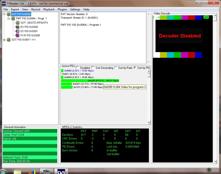

I'm sure people know about this one but I have just discovered TSreader - there's a free version for download at http://www.coolstf.com/tsreader/ and shows the breakdown of the MPEG transport as transmitted by our DATV equipment.
It's particularly useful as it will directly read the live UDP output from Tutioune and give a real time display of the TS components and the bit rates used etc.
digithin 2.jpg (153.7 KiB) Viewed 2595 times
A bit geekish I guess but very useful when trying to work out what is going on when things don't decode - I'm currently playing with putting the Rpi directly in to a DTX1 via the TS dock PCB to give a total solution from 146 MHz to 2 Ghz and beyond for DATV and RB-TV and being able to see in to the Transport stream is very useful.
