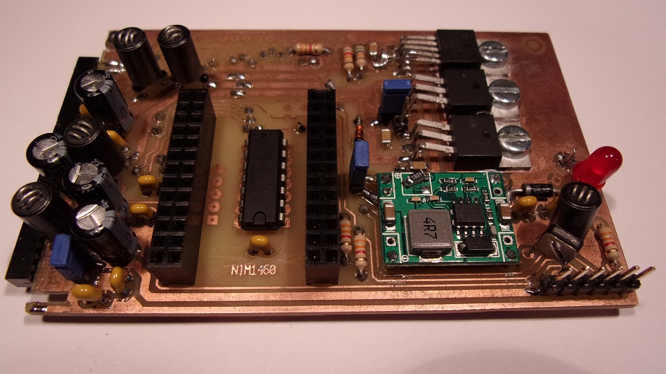

The updated prototype pcb is working and all being well, it should be going to the manufacturer in the next few day after a few minor tweaks.
I've used the adjustable version of the MCP1826 instead of an SMD type, as it's easier to work with. The sockets for the NIM module are optional - the NIM will fit directly onto the pcb. It may need some extra heatsinking if it's going to be used at high symbol rates with the low SR box unticked.
I went over to Warrington ARC's ATV day this afternoon, which gave me the chance to test the pcb at 125k symbols / second with a DATV-Express transmitter. The tx power was adjusted until the MER reached 30dB. Does a signal strength of -68dBm suggest that the power supplies are low noise? I wonder what others have been getting.

It is difficult to give an answer with just this test.
using Samsung Minitiouner I have this result : 30 dB MER for -80 dBm input ( in reality -95 dBm input if we know that the booster add 15 dB)

Thanks. Very informative. My Eardatek seems very similar to F9ZG's, so I'll assume it's working reasonably well.

Very interesting results,
So far I have had best performance from the Eardatek, but my Samsung is a DNBU105121ST not a DNBU10711IST , it has been imposable to find the Samsung DNBU10711IST ,( I wonder what equipment was using that one?). However I was using a switching regulator with two much ripple on both for the initial tests.
Will redo the power supply on my Samsung and test again.
I had already changed the power supply arrangement on the Eardatek, to the same devices as Brian will use on the PCB, ripple is reduced and nothing gets hot either.( no heat sink needed for SR 100-4000 but if you want to use it for Sat TV it will draw more current as has been mentioned before)
