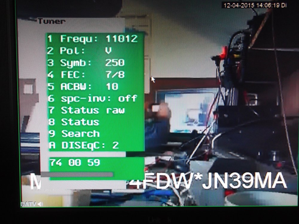

nokia 9600 with dvb2000 can decode at the lowest SR250, look at the picture , with my digilite by udp and with c525 webcam
73 f4fdw Laurent
73 f4fdw Laurent
- sr250.jpg (137.04 KiB) Viewed 5250 times

Many thanks Laurent
I will have another go at decoding low symbol rate datv with the 9600 and report back later this week.
I remember in the past it was a very good programme by Dr Overflow. Hopefully this will give it another lease of life.
