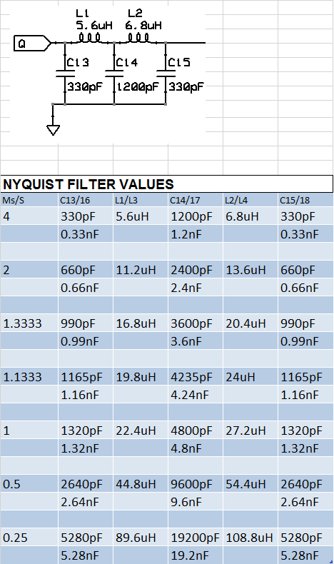

I have been looking for Nyquist filter values for the lower symbol rates for some experiments I am doing.
John O'Loughlin kindly sent me an Excel spreadsheet he made for Digilite.
I have inputted the ones I needed and the results are below, of course I will need to select the nearest preferred values.
Posting here for info and any comments.
Colin G4KLB

Re: Nyquist Filter Values
Thank you Jean Pierre,
I have been trying to find the best Values for the low symbol rates, as I believed we don't have the optimum values yet,
Talking to John he states 'The calculations on my spreadsheet simply scale the values from Dave’s 4Ms/s chart entry according to the frequency change'
I assume some rounding up/down would have been done on the 4Ms/S to use preferred values, so using these values to calculate say 250Ks/S would introduce a significant error.
We have been unable to find a calculator that gives component values.
I posted the chart to provoke some discussion, so apology's to John for dropping him in it! He had only sent it to me for info, and was not expecting it to be published!
I had no other source for the values to use, so was a reasonable starting point.
Hopefully someone reading this will have been down this route and be able to guide us.
Hi Ken,
The DigiLite filter is terminated in 100 ohms, could you re-plot with that value?
A raised cosine filter is the norm for QPSK filtering, any chance you have found software for that type?

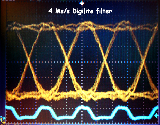

The Nyquist filter reduces the transmission bandwidth required. However the pulses from the serializer passing through the filter cause ringing on the output. The energy of one pulse can spill over into subsequent time slots causing ISI - Inter Symbol Interference. To reduce this effect the filter should be designed to cause the nulls in the waveforms from the previous pulses to occur at the peak of the current pulse. This makes it much more than just a low pass filter.
www.feng.pucrs.br/~decastro/pdf/ShapingFilterDesign.pdf
The Eye diagram should show if this result has been achieved. I haven’t had a chance to try this on a DigiLite yet. I think the Eye pattern could be displayed on a Digilite by syncing on the clock signal at PIC pin 25 and displaying the output of the filter.
http://users.ecs.soton.ac.uk/sqc/EL334/MODEM-L4.pdf
Example Eye diagrams on pages 11-13
I got a chance to make the Eye pattern on a 4Ms/s Digilite today. It looks surprisingly good. Now someone who runs low symbol rates needs to try it.
John
