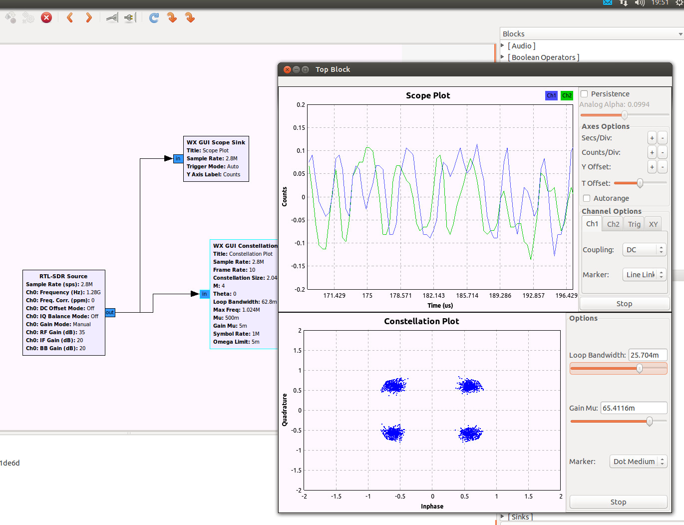

Just had a go with GNU Radio and you can easily show the constellation of a 1 and 2 Ms QPSK signal using the Realtek DVB sdr dongle (RTL2832/R820)
2Ms looks a bit stretched in amplitude probably due to bandwidth? but 1Ms looks ok, see attached image.
No idea how accurate this is but it does show what is going on without too much trouble, GNU Radio is a big download/long install if you have not already used it!
