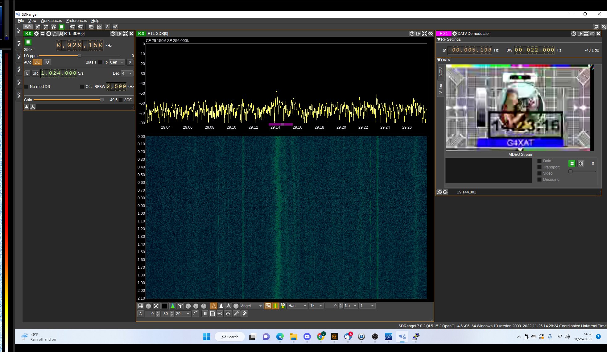

I saw a video signal on 29.150 MHz briefly around 1540UTC on the K3FEF KiwiSDR I could also just hear myself using FM voice soon afterwards.100 watts to OCF dipole..

Watching the signals this morning in a rainy Baltimore day. Lower than they had been, but Gareth's signal all of a sudden came way up and data locked immediately, just prior to him shutting it off.

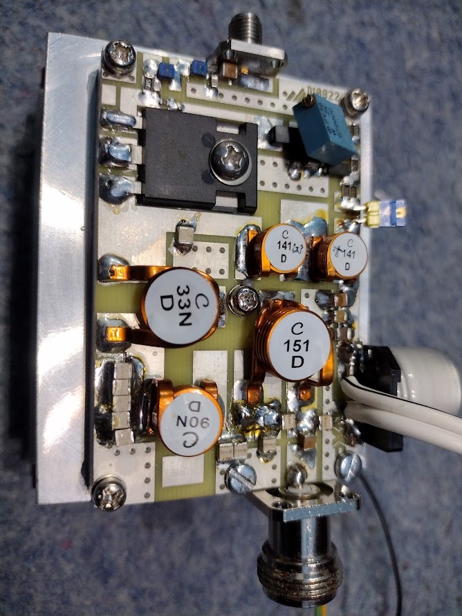

Finished the MRF300 '27MHz application note' amp today and fired it up. It does go rather well although I found the bias was poorly tracking as it all warmed up. Simple circuit needs some thought, but an easy 200W at about 50V & 5.5 amps.

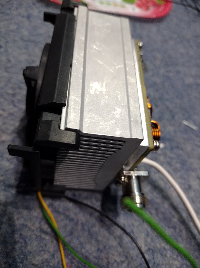

Pics show the amp, heatsink is OK at around 100W but needs more airflow to sustain 200W. The fans out of the 70cms NEC TV amp look suitable.....

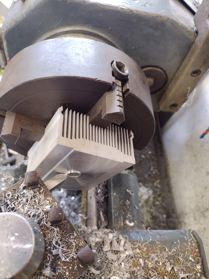

The heatsink was machined fully flat to completely match the supplied MRF Dev kit aluminium block.

Interesting you didn't need to modify that choke - incidentally I got 300W once I did the Mod. Probably 200W beforehand. The shoulders get worse above 100W, but I am using 48V. I did notice it got better at higher voltages. Also noted the drift in the bias. We need to fix that as it is quite bad, it doubles.

I did mod the choke Mike, the "33" one has the top coil turn bent up at about 40 degrees. I didn't drive it any harder as only had a dvbs source at the time.
Also wasn't sure the heatsink was enough.....
