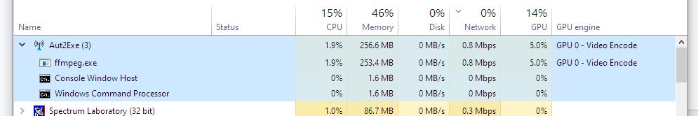

I'm not sure if this has been reported before but something to look into..
The situation:
I have freestreamcoder running and sending TS to my pluto.
If i now close freestreamcoder without pressing stop (i know it's wrong but...) the window closes but the exe is still running in task manager.
Often i find out when i start up freestreamcoder again later and press start and it does not work until i press stop then start again.
Sometimes i have seen only the ffmpeg.exe remaining in task manager but not Aut2Exe, when this happens i have two streams being sent to the pluto so the tx is corrupt.

Re: FreeStreamCoder Software to Generate Mpeg-TS Streams >> New V2.77
Hello M0DTS
Thank you for this feedback.
indeed it was an oversight in my code. This is fixed for the next version.
In the meantime, you have to actually exit with the exit button !
73 Dominique F1EJP
