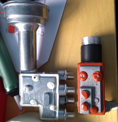

Having got SDRConsole working like a charm on locking to the NB beacon, I'm finding I need both a horizontal and vertical capability at the same time for my home station. I have a four output PLL Octagon (originally bought so I could externally lock)that now de-cased looks the same as the single output mechanical dimensions wise. Before I cut the horn off the end (so it will fit a dual band patch), any reason why this won't work as just as well?

It will - but if you try to inject a reference you may find it oscillates and destroys itself, best not to open. If you do, there is advice on the Wiki on how to do it.

Thanks Mike, I won't need the reference now so I'll go ahead and chop the horn off.

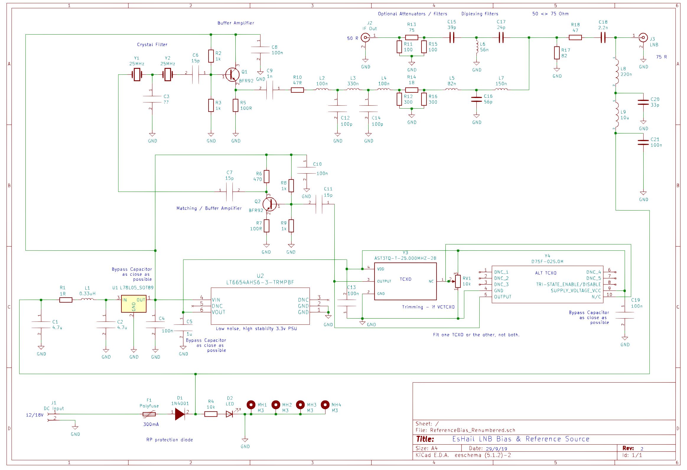

Wondering if this sort of thing is likely to be any use - should I get some PCBs made up? Before anyone points it out, I couldn't get the right 3D model for the 90 degree panel mount BNC/F connector and I have not even analysed it yet to see if the design makes any sense.
The idea is to inject 10/25/27 MHz and 12V DC to the LNB and get back the IF, all on one cable. At the LNB end, filter off the 10/25/27 MHz and use it to lock the PLL. I have several surplus PLL LNBs that do this already, all with 10MHz references.

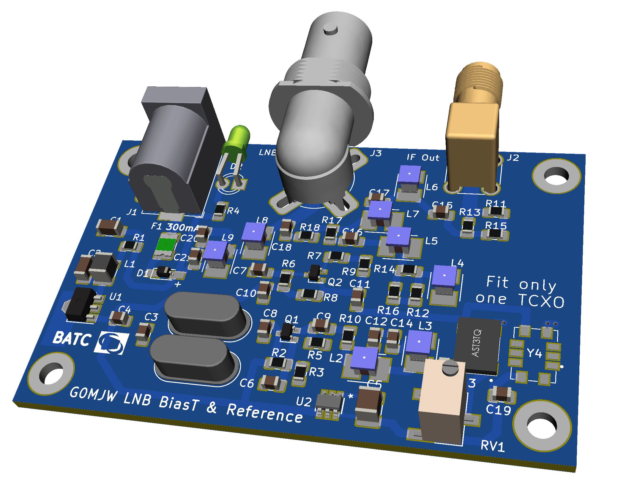

Hello Mike @G0MJW , I ordered one of your (designed) Bias-T - reference pcb's via the BATC shop https://batc.org.uk/shop/lnb-bias-t-and ... blank-pcb/ , and also started to order the components, could You give me the pcb's dimensions so I could look for a suitable enclosure?

I have done a little update and added a TCXO reference and bias board to compliment the external reference board that's in the shop.

Intentional but brief thread necromancy: for consistency with other "blank PCBs are available from the BATC Shop" projects and to facilitate possible updates (e.g. when a part goes obsolete, as it has been the case with the BNC connectors) I have gathered the details of and compiled BoMs for both of Mike's Bias-T boards on the BATC Wiki: https://wiki.batc.org.uk/G0MJW_Bias-T_a ... ion_boards . Corrections, improvements, high-resolution / vector version of the schematics, and links on the relevant BATC Shop pages welcome!

That's useful. Perhaps the updates can be put in the Wiki? Parts come and go with distressing rapidity. That board was designed to allow several variants, hence the odd slotted holes.

That's only normally the case if your reference source has poor phase noise. It affects wideband signals more than reduced bandwidth DATV or SSB. IF you look at a commercial transponder, you can measure the MER even if you can't decode the TS, it shows a significant difference. Even the Leo Bodnar reference is not all that good, especially if compared to a well designed crystal oscillator. This board was designed before the Bullseye LNB became available, and mostly with SSB in mind, strictly speaking you don't need it for DATV as long as you know your offset, but if you use a clean source, then you get a good result. Quite a bit of effort was made to try to clean up the phase noise as far as possible, hence the filtering and unusual use of a low noise voltage reference as an oscillator supply. For DATV use the Bullseye is now a better choice as it is quite stable and doesn't require an external reference and can be easily calibrated onto frequency.
