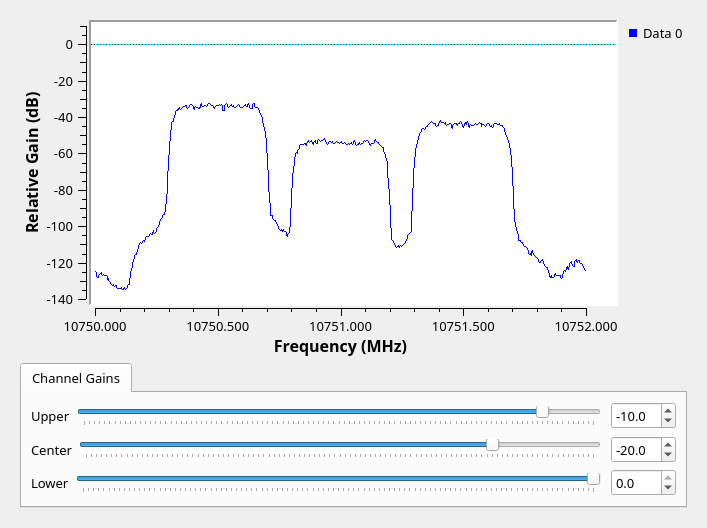

Adjacent signal test setup
I now have a good test setup for examining the behaviour of a receiver in the presence of closely spaced signals. This took a bit of effort to get right, so to save anyone else the trouble in future, I've cleaned it up and published it with instructions on GitHub here:
https://github.com/martinling/dvbs2-rx-testbench
This uses either a HackRF or Pluto to generate three simultaneous 333kS signals at 500kHz spacing, at a level suitable to feed directly into a receiver in place of the LNB feed. By tweaking settings in the flowgraph and the Makefile, the same setup can also be used with the modulation/coding/bitrate parameters of your choice. You can also adjust the relative levels of the three signals whilst it's running to see how the receiver responds:
