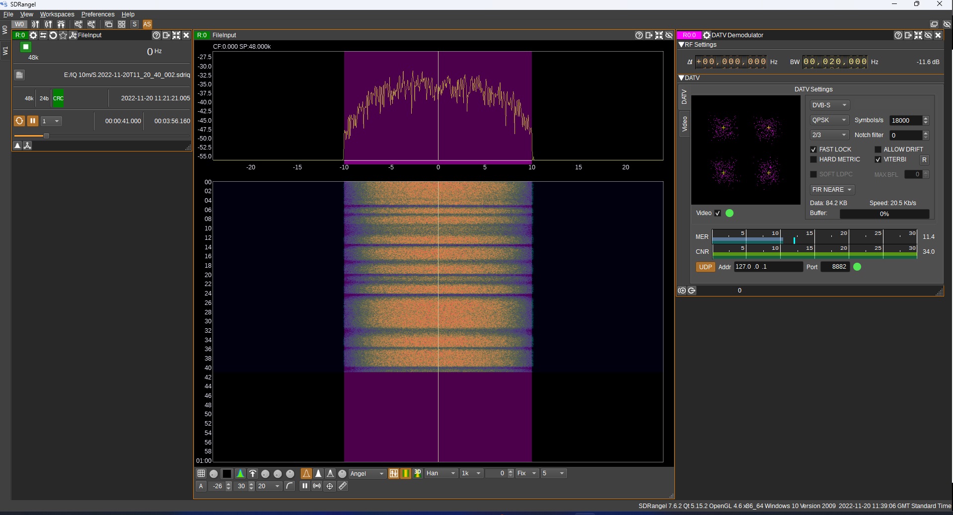

I've made an IQ file recording which you could test with in SDRAngel if you want to have a play about.
DVB-S 18Ks 2/3FEC - (80MB) https://www.dropbox.com/s/2v7o5rtowo1vl ... sdriq?dl=1
FOR REFERENCE, DOES NOT DECODE IN SDRAngel: DVB-S2, 18Ks, 2/3FEC - (30MB) https://www.dropbox.com/s/fpsj5ksulehkk ... sdriq?dl=1
Here's a screenshot of the settings in SDRAngel to playback the recording and and decode the DVB-S signal.
- SDRAngel_IQ_Playback.jpg (336.64 KiB) Viewed 5905 times
- Posts: 1488
Excellent Rob, that decodes in my SDRAngel too now so I know my settings are good.

Hello Rob, thank you for posting the IQ recording of DVB-S2 over HF. I had a look and it seems that either your spectrum is inverted or I am not reading the sdriq file format correctly. Anyway, after tweaking leandvb a little I got enough TS to decode this. To make things easier I'd recommend enabling pilots and transmitting short frame.

The IQ file is recorded from a kiwisdr, in SDRAngel there's the option to swap the L/R audio input so that will explain the inversion.
I'll try with pilots and short frame etc and see what happens!
