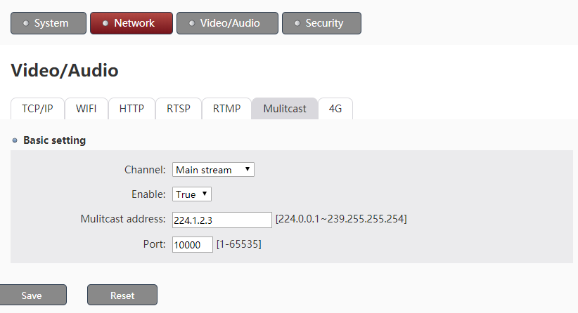

Hi Tim, the source streamer is one of these https://www.ebay.co.uk/itm/H-265-H-264- ... 2749.l2649
I tend to prefer hardware devices so don't use OBS or Vmix, I do all of my video switching with a Blackmagic ATEM.
Here are the relevant parts of my modified nanoencode.sh:
This line accepts the UDP multicast H.265 stream and outputs it (should be one long line). As the streamer allows pretty accurate setting of the bitrate for video and audio, I am currently experimenting with outputting it directly without transcoding which should be much more efficient.

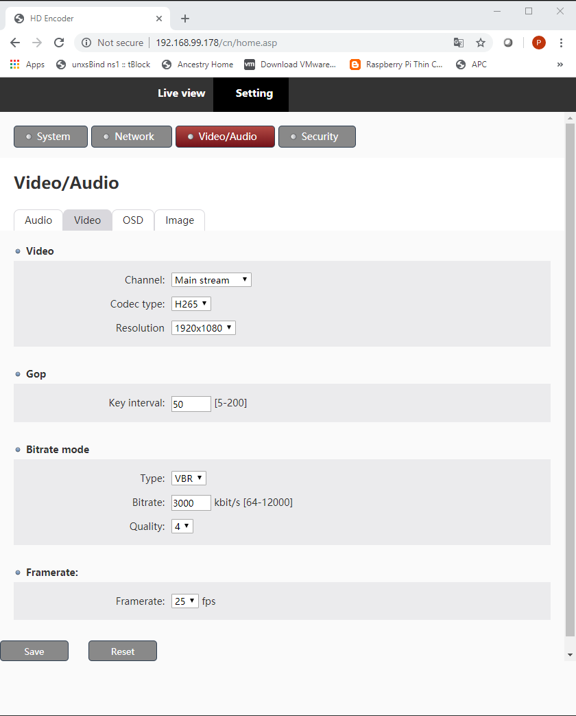

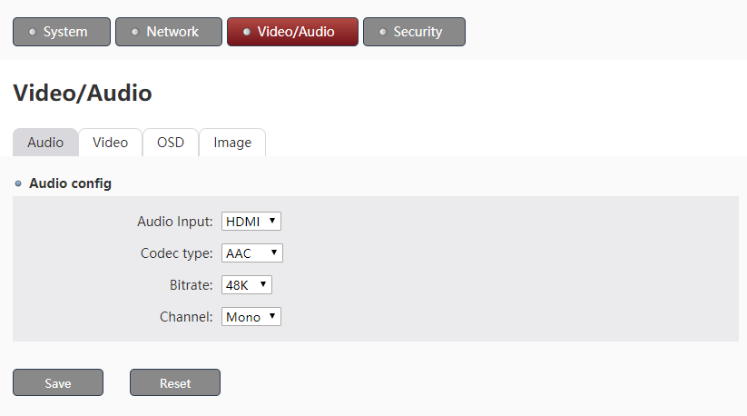

Hi Tim.
Here are the settings for the encoder. Only useful if you have the same device I suppose but it gives you an idea!

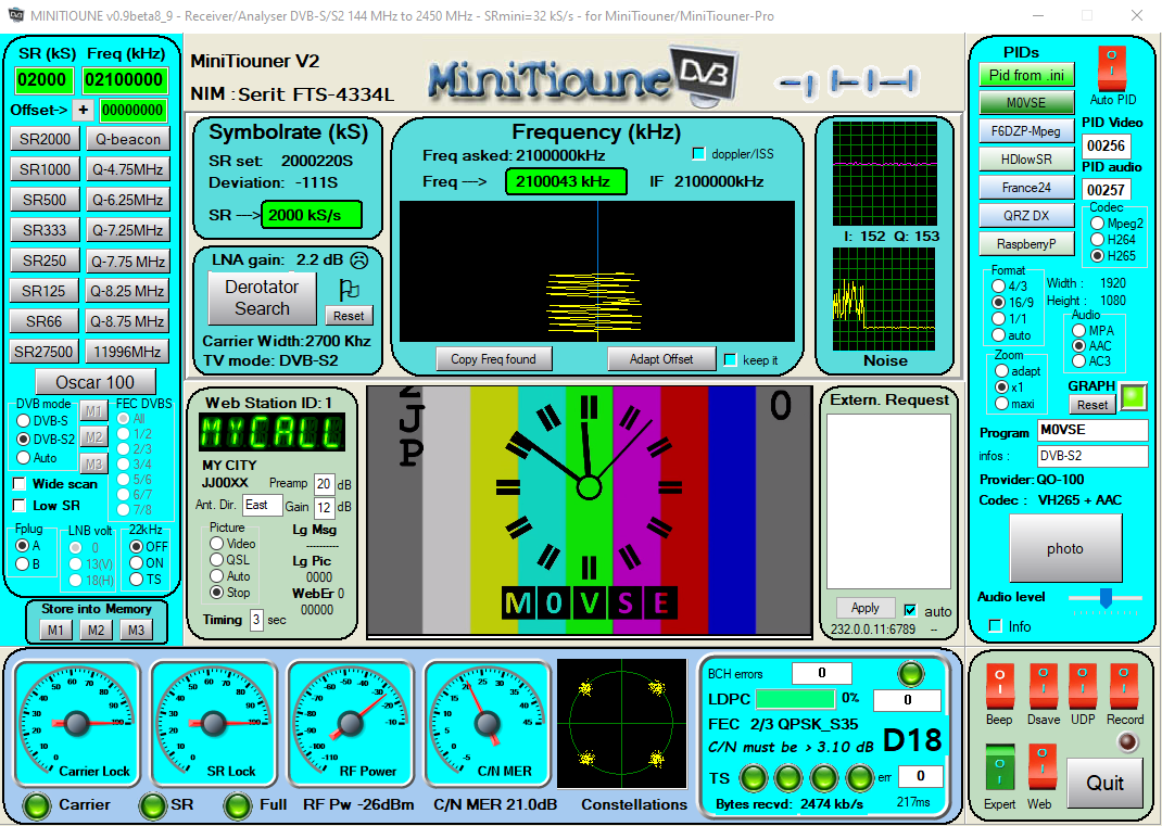

Here is the output with the LimeSDR connected directly (hence the rather high MER!)
I am simultaneously streaming to the BATC (using the same streamer). The image is an HTML template that I created of the BBC clock being played by a CasparCG server into a BMD Decklink card. The clock makes a useful latency test.
